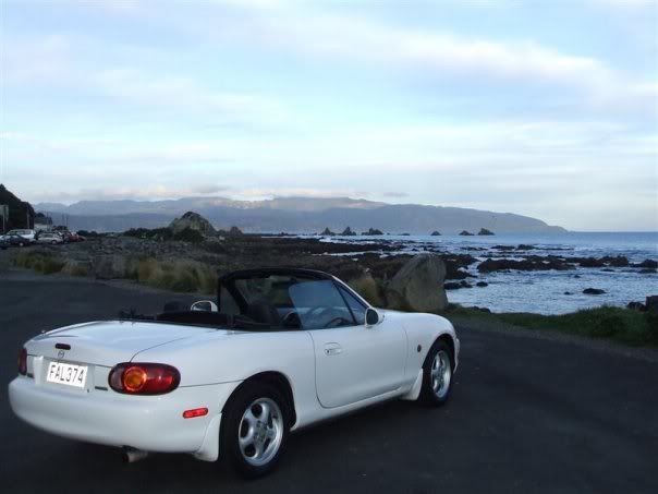

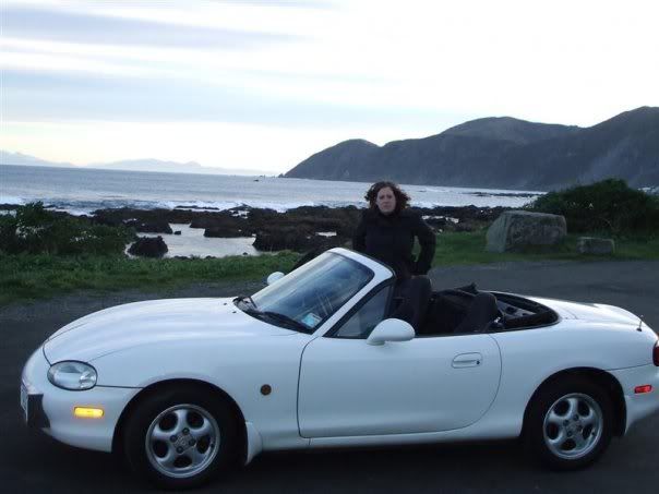

hi guys/girls
the mrs has just bought a mark 2 (i beleive) 98 mx5
we just picked it up today
.... Image
and while she is a tiny scottish lass, im a 6'4" kiwi lad, and ill be buggered if i can safely drive the car with my knee jammed against the steering wheel and the consul, i was thinking of just putting a smaller steering wheel on it and putting a resitor in and be done with the drivers air bag, but the mrs wont have a bar of that :D and she'll be the one mostly driving the car so thats fair enough i suppose....
so my real question is .... is there a smaller steering wheel out there (aftermarket or from another mazda) that will fit that is a smaller diameter
and still has an airbag???
