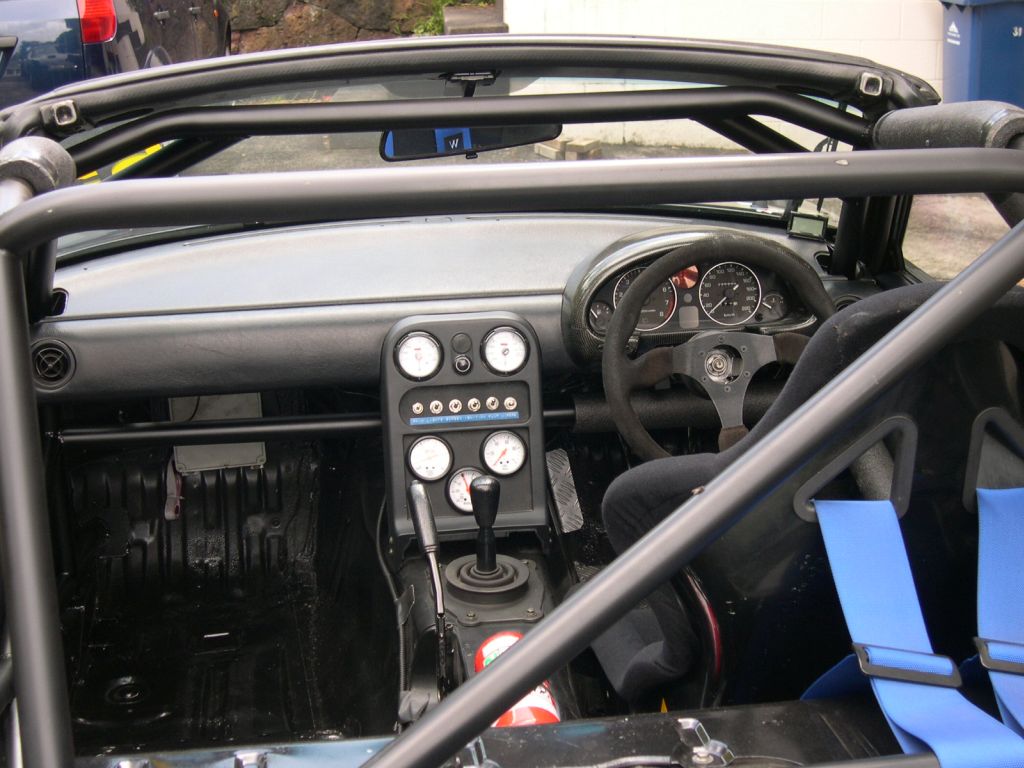

Now that I can (hopefully) upload photos
Proposed the race life to little Loki this morning...
OHH too exciting!

Post by MrGrey » Sun Oct 11, 2015 10:43 am
it almost looks like you are bowling :D

Post by Keith Jones » Tue Aug 16, 2016 12:29 pm
Picture of the dash in my old car.

I've seen you lurking on the facebook pages! Personally ive got 2mm ABS sheet for the doorcards, which i plan on replacing with the carbon fibre (for looks, not for weight). But id say its probably easiest to get some standard doorcards and just pull off the handles etc, and make up a dummy knob for closing the door.
I've still got ALL my dash (but binned the AC, replaced with the joiner pipe), because i figure i can just keep adding power ;). I think a fully naked car is ugly as sin, and you need no sharp objects if you plan on having passengers, so id remove everything behind the dash and keep the dash itself. Once again personally, i've kept the heater so if for some reason i need a LITTLE more coolant in the system to HOPEFULLY give me that extra 10s before i cook a motor (and for efficient demisting).
With windows, go lexan/polycarb, NOT perspex. But most of your weight is in window motors (if you have them), so is it really worth it? If you're going that far, what about removing the sound deadening, unneeded wiring, control circuits, cutting the doors apart, removing the lock mechanisms etc etc etc. I'm not trying to be a downer, but if you're going all this way, make it a full racecar, compromise makes you SLOW.
