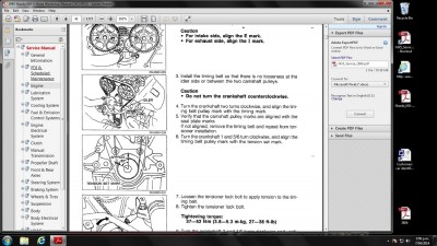

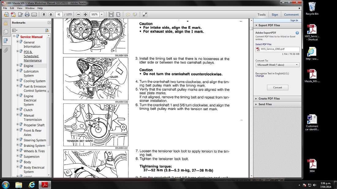

Did you set the tension at the correct mark?
Otherwise something could be rubbing if a belt has got a nick in it somehow?

I should have replaced the tensioner helper spring (free length slightly over spec), but I didn't fancy waiting on parts again so set tension, checked deflection which seemed okay and proceeded. Maybe I didn't set tight enough though.

I'm having difficulty verifying if I've set the belt tension correctly. It seems all good at the tension set mark, but if I rotate the engine to #1 TDC for example, there is more slack than there was at the the tension mark. Is this to be expected (cam position causing load to be taken off belt between pulleys)?

Are you rotating the engine clockwise?...the tension in other positions is bound to differ slightly just as you said regarding cam positions.

It's alive! I suspect the tensioner shifted as I torqued it down.
