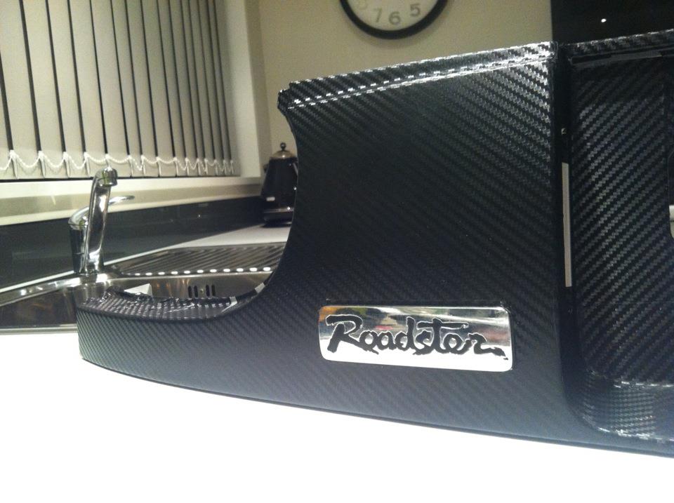

I've undertaken this project myself....
Patience is everything. Looks good, as long as you don't look at mine too close in the tiny wee corners etc haha

Post by tomtikki » Tue Jul 23, 2013 10:48 am
Yeah I dont have much patience, yours looks WAY better up close than mine. :(
Well done!
-I really need to redo mine now I seen that :wink: damm.

Post by brooke5 » Tue Jul 23, 2013 12:23 pm
Haha cheers mate!
I actually quite enjoyed it, probably took about 5 hours over a few nights.
I'm thinking I will paint it black, or drop Carbonmiata a line in the future, but the vinyl is pretty dam effective! And quite hardy, mind you my car is bit of a garage queen haha!

Post by MrGrey » Fri Jul 26, 2013 3:46 pm
took 3 attempts before I was happy with the result.
due to the depth of the license plate area stretching the vinyl was ..... problematic :wink:
while I had everything apart I put on a number plate frame and painted the outer lips of the tail lights (the plastic outer rims where too light for my tastes)

Post by brooke5 » Mon Jul 29, 2013 10:17 am
[quote="MrGrey"]took 3 attempts before I was happy with the result.
here's how it looks at the moment.
Looks good, how did you tackle the part around the number plate? mines like a jig saw puzzle lol

Post by MrGrey » Mon Jul 29, 2013 7:56 pm
The number plate bit was tricky, I did my best to stretch/spread it down into the bottom flat piece and the 2 side corners and trimmed it off about 25 mm in on the bottom.I then had 1 big rectangle for behind the number plate and a strip under each of the plate lights.
It took 3 attempts (ripping it all off and restarting with fresh vinyl) until I got it to a point that I was happy enough with the outcome. I am glad I did it, but it was a bitch to wrap. It is far from perfect but looks good to the untrained eye.
