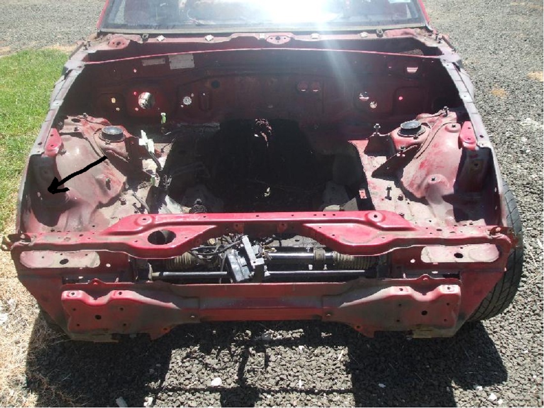

Ok so noticed a small patch of coolant under my car today, seems like it kind of dripped a lot and then stopped, managed to trace it back to the chassis rail on the drivers side pretty much in line with where the front wheel arch ends, there's a split/overlap of metal on the chassis rail and a drain hole(?) where it seems to be dripping from(the drain hole) and seeping though(the seam in the metal). I also noticed a bit which looks like its run down from the overflow but not as much as leaked from under the chassis rail. So I pulled the carpet up a bit on the drivers side and had a feel around, it was damp in a few patches but nothing sitting, I think to line up with where its coming from in the chassis rail, the leak would be coming in the section forward of the foot well, so I was thinking maybe a leak in the heater system? But is that not all located on the passenger side? Any help much appreciated as I don't want to dive in and pull the dash when it turns out to be something else.

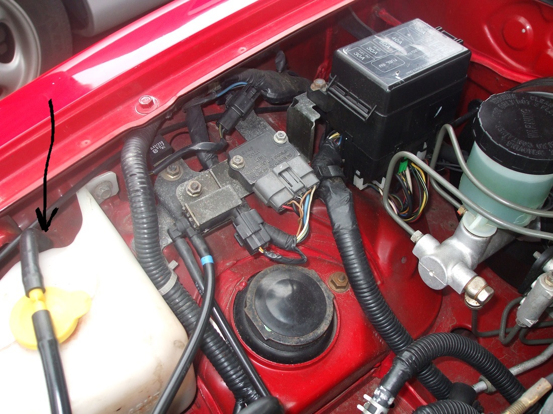

Probably your overflow bottle..or the hose that comes out of it and its running back towards the chassis rail.
You are either over filling it or you have blocked coolant system,faulty thermostat,leaking water-pump or air entering the system.

That's the thing though, there's no trace of coolant anywhere near that hole from the overflow bottle or anywhere around the engine for that matter, it's just the hole and that seam that are wet, the rest is bone dry, waterpump went not long after I got the car so that was replaced along with the thermostat. I got a few pics, they turned out pretty crap so bear with me
The second pic is just a close up of the first, that's the front left tyre you can see for reference.

That bung is nothing but I still feel the water is travelling from the overflow hose that comes out of the bottle & then running from there.Look at the pics and maybe take out the bottle and see if there is coolant stain anywhere.
