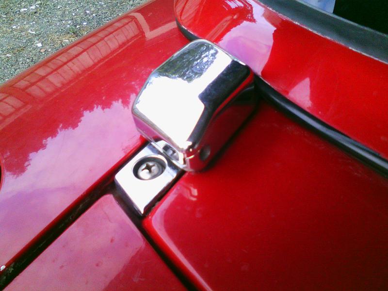

the lids on the shackles that hide the frankenstein bolts (that hold down the rear of the hardtop) are a little loose and I would like to stop them flopping open by putting some countersunk screws in them but am unsure of the screw size.
does anyone know what size they are? both a 4mm and 5/32th's screw felt like they would fit but i didn't want to force them and shag the threads in the shackle (minor oxidization means that even the correct screw and thread will be tight)
I am referring to the single screw hole shown in the center of the pic.
any help is appreciated =D

They are nothing special....borrow one from someones hardtop, :D and Blacks or a specialist fastener supplier will match it...suggest using a stainless one and being countersunk, a 'blind man would be pleased to see it' !

Post by Dez » Fri Feb 01, 2013 8:11 am
You should be able to get these from Blacks Fasteners in stainless for less
than $3 a pair. The screw as measured from my car is: Stainless CSK 4mm x 0.70 pitch,
thread length 9mm.
There is also an option for allen key drive as well
Hope this helps
Dez
