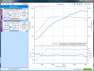

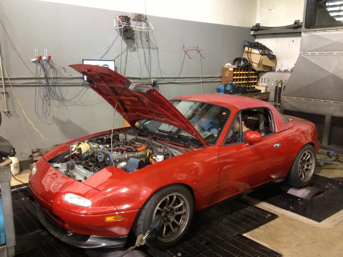

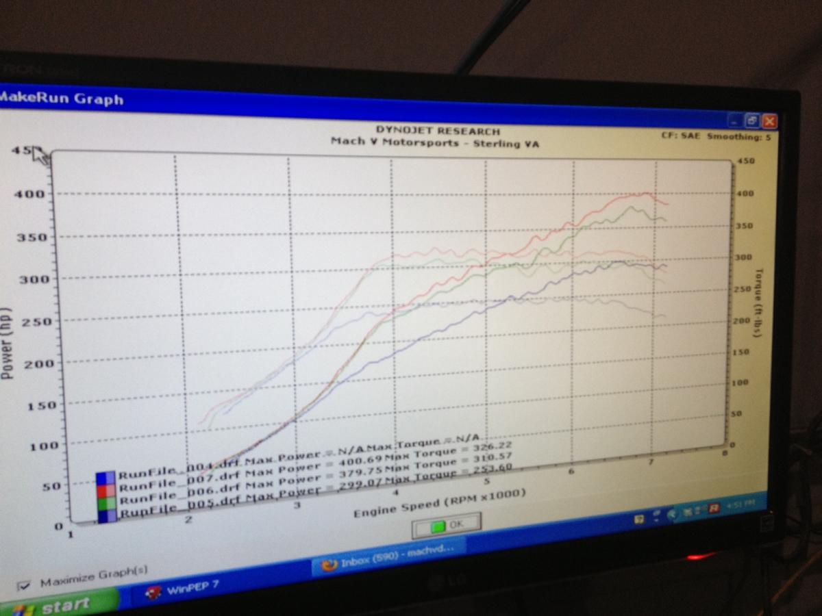

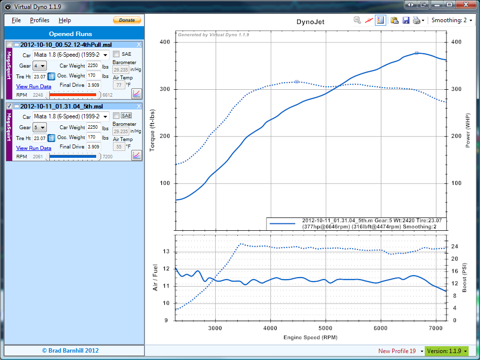

Post by Kieran » Mon Oct 15, 2012 11:03 am
He Hit 400 hp
