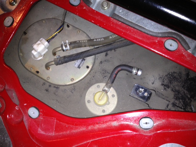

Post by Donovan » Wed Oct 24, 2012 9:46 pm
So poking around trying to find where the fumes are coming from, is it ok to have that line blocked off the way it is?
Post by SLYDIT » Wed Oct 24, 2012 10:14 pm
the vent for the tank is there for a reason.
petrol sloshing around in a tank creates vapour that needs to be released.
without it your tank is a sealed system that just keeps building pressure. Reconnect your vapour recovery canister and port it intto the inlet manifold.
