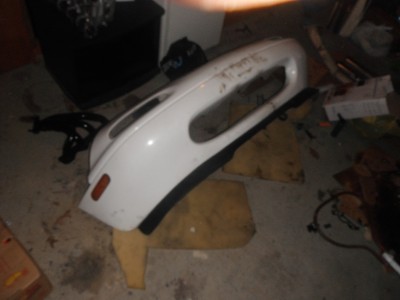

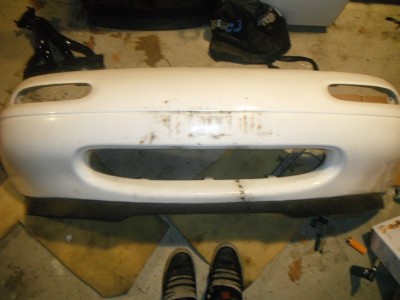

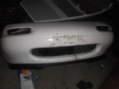

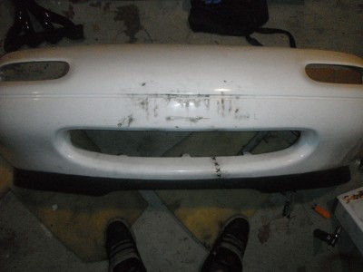

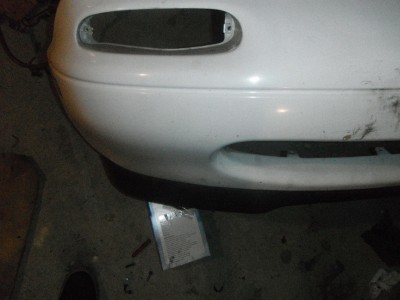

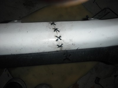

modified a front lip to fit standard bumper

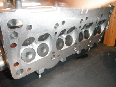

heads port matched, skimmed, new valves and 3 angle seat and assembled.

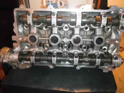

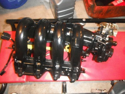

port matched intake to head ports, stripped cleaned painted and assembled

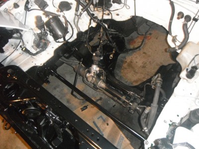

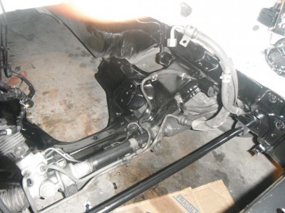

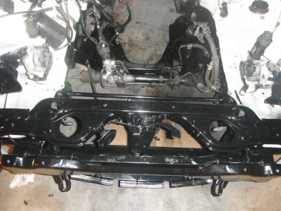

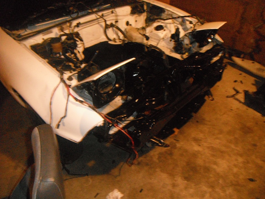

painted engine bay lower half, xmember, front bar and supports and few other bits

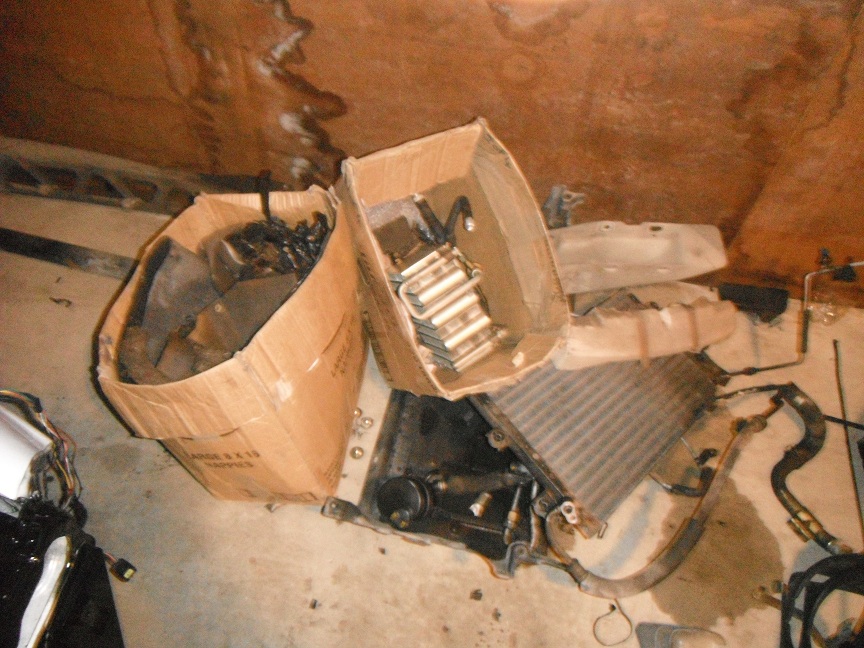

stripped boot completely, removed sound deadening
generally went on a slight diet all over the car

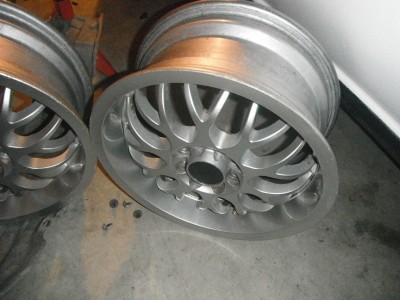

received new wheels

received new wheels

il keep this updated anyhow, got the block half done, and o/haul on the box. all in all spent a huge 750 bux so far, not much at all considering its getting a complete rebuild
its a p10 primera front bumper lip from factory, bolts up fine, heat it to fit, cut to length and hey hey its done, wheels are probably going satin black tbh, i want some 13s to polish up on the sidetomtikki wrote:Nice sewing job on the bumper, Frankenstein would be proud. Splitter looks great but no idea what you've grafted to make it.. Go on, whats the trick?
Those rims are gunna look sweet, a quick polish job on the lip would add some bling...
