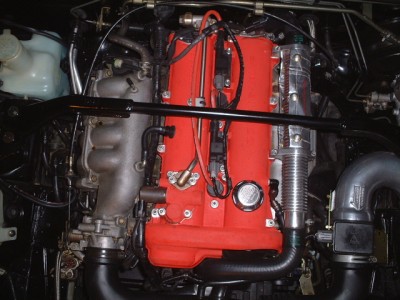

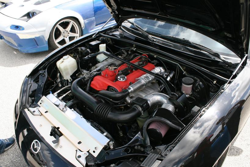

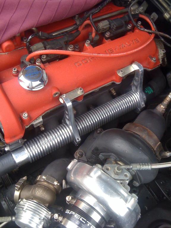

Post by Kieran » Wed Jun 27, 2012 3:45 pm
Photo dump
Something like this
Post by WideOpenThrottle » Wed Jun 27, 2012 5:33 pm
Hi Kieran-that looks nice but part of my coolant re-route was to avoid my headers & dump-pipe heating the plumbing and as sprsta has done it i thought it would be fairly easy.
I will carry on with my original plan as apart from the pipe i am pretty well there. It will work once i free up more space with a custom clutch pipe [Waitemata Hydraulics say they do them frequently].
Thing is every time you change tack something else trips you up...but i will succeed!
