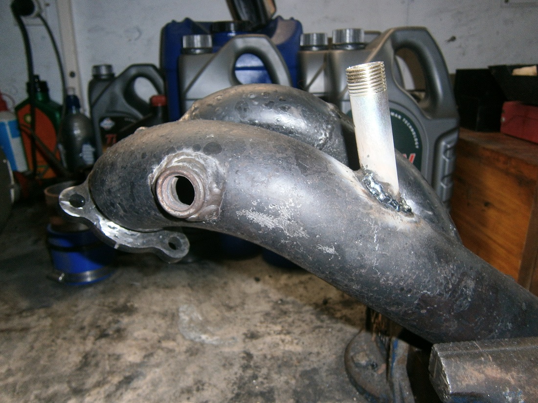

Post by WideOpenThrottle » Sun Jun 14, 2015 8:02 pm
New flange to suit my new turbo plus crankcase vent to exhaust, NB front suspension & hubs, NB front sway-bar.
