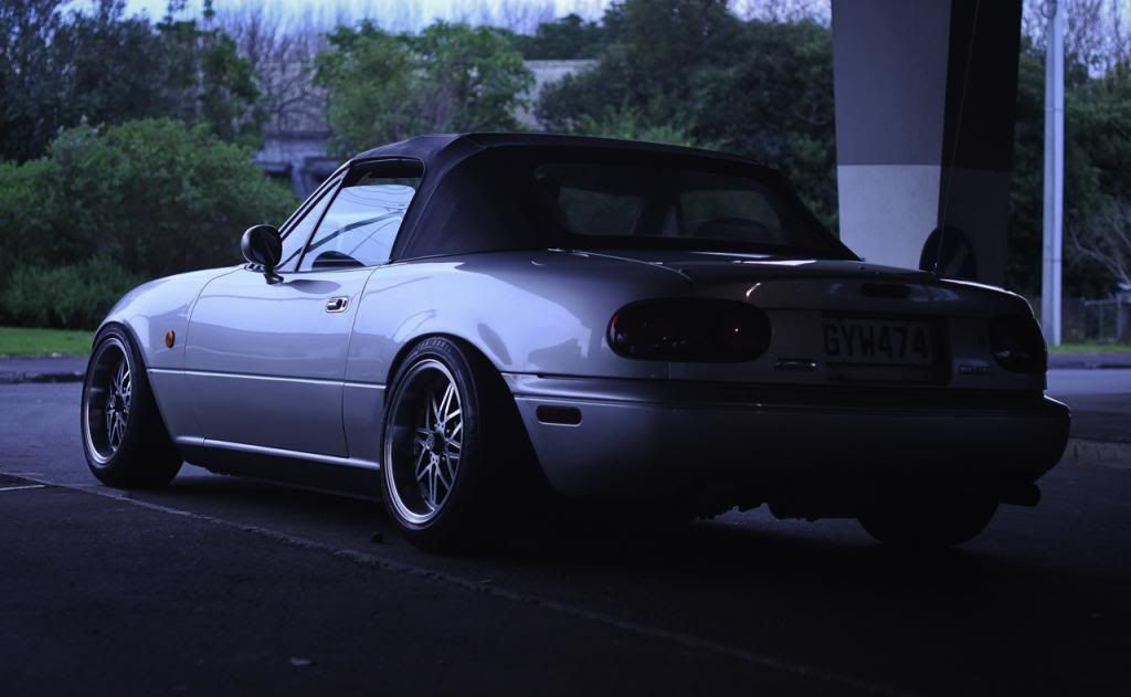

BRM wrote:Getting there...
Nice! You've done the rear bumper cut. I'm thinking about it but my car isn't low enough to pull it off. And you need a shiny exhaust to compliment it.
Post by BRM » Sat Aug 03, 2013 6:43 pm
I haven't seen it done on a high car...
Mine's not That low..
Yup..
Definitely needs a shine up in the rear now..
I've a few things planned ;)
Rear section of zorst is one of them.

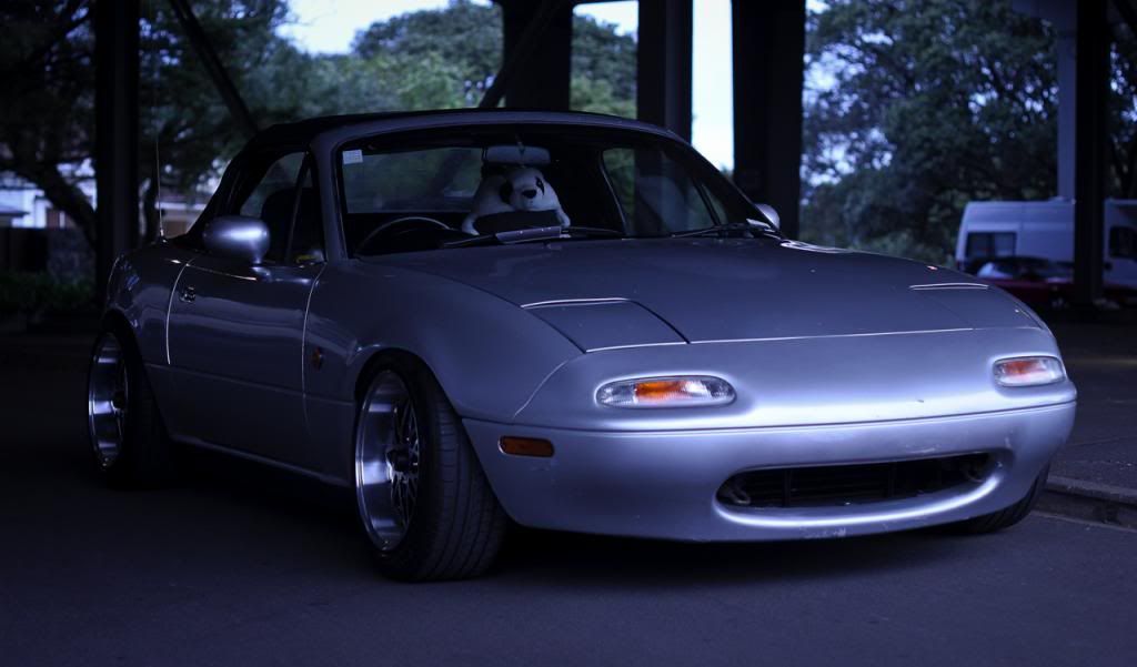

Post by BRM » Sat Aug 03, 2013 9:13 pm
Couple from today before my camera died...
Needs a lip =\
Post by dylann » Sat Aug 03, 2013 10:27 pm
Fitment looks good man, are they +25 or 0? I'm never good with judging offset haha.
Post by BRM » Sat Aug 03, 2013 10:33 pm
-5 up front and +0 at back,
Either going +10 in the rear or a slight pull....
Post by dylann » Sun Aug 04, 2013 12:40 pm
Oh nice, spacers I assume?
I'm running +0 at the rear with a slight pull, like a cm or 2 at max and I get no rub at all. Looks a bit mexi though cause I havent lowered the front and Im on 195 50s :(

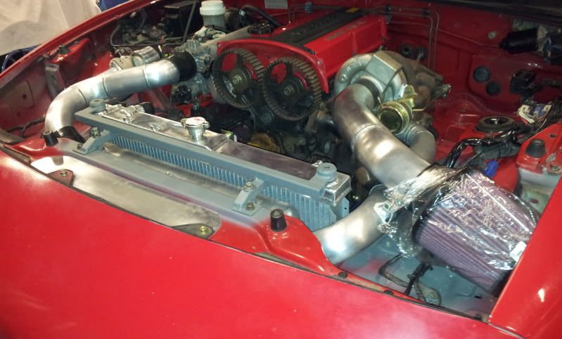

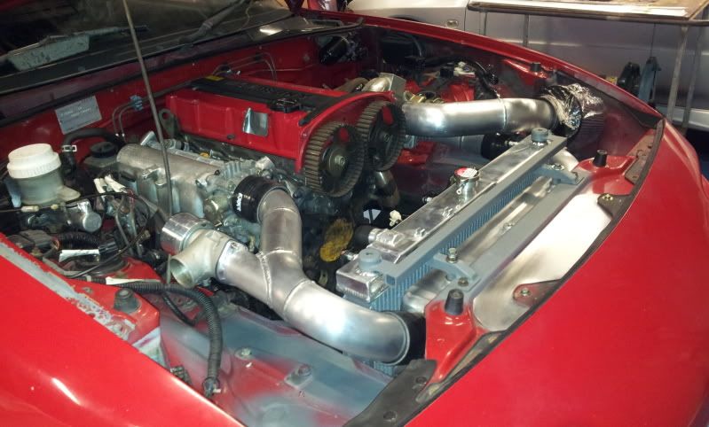

mjrstar- Can you explain the reasoning behind angling your blowoff valve piping that way? Wouldn't it be better to angle against the normal airflow to avoid breaking laminar flow as much as possible? On boost the air is going to want to go up the blow off valve pipe and off boost/throttle butterfly closed it's going to tend to not want to go up that way...which seems backwards to me?

I'm open do discussion on this, hey some people even mount the BOV's up against the turbo (with reasonable results). and some of that borg warner stuff comes with intergrated BOV's
short answer:
The thought was that the best way to vent is in the same direction the the source of flow comes from. you are trying to maintain compressor outlet flow direction (minimal flow reversion)
Not so short answer:
The void in behind the take off for the bov is tiny in relation to the flow rate of the turbo so not concerned about the time taken to equalise pressure in there , I'm not sure how turbulent that area will get as it build boost pressure.
not so short answer continued...
But like most under bonnet stuff it really just comes to packaging, i couldn't afford the room on the inner side of the pipe as that's where the top coolant hose will go, and i wanted to reduce the hanging weight that would be evident it if were poked on at 90 degrees.. Plus I think it looks fairly tidy in it's current position.. :lol:

mjrstar wrote:I'm open do discussion on this, hey some people even mount the BOV's up against the turbo (with reasonable results). and some of that borg warner stuff comes with intergrated BOV's
short answer:
put it at the throttle plate. that way you keep the volume of air flowing through the intercooler and pipes. if you put it at the turbo, the air in the pipes and intercooler still stalls and has to restart again...
