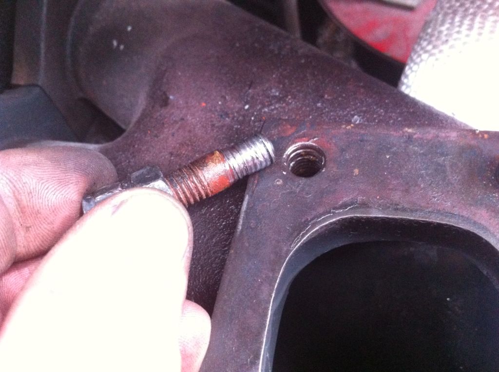

The 2 rearward studs/threads holding the turbo to the manifold are not good, I eventually managed to remove the drivers side stud but its threads are manked and so do the threads in the manifold appear a bit manly also (Pic. 2). The other (passenger side) rearward stud eventually snapped after about an hour of wiggling it back and forward w/ CRC… it's got about ½ a nut worth of thread sticking out and I can still wind in in and out about a turn or so but it isn't coming out any further w/ my equipment/skill level I'm afraid.
So I said to myself, 'oh stuff it I will take the manifold off and just get on my racing bike and off and take it to a mate of a mate down in Wairau Valley somewhere who has some sort of machine shop get him to easy out and re-cut or whatever is required…
But, I cannot get the manifold off the head, I have tried wiggling hitting and levering w/ a crow bar and pieces of wood etc but it appears I will need to splay the sections to make room, it's all jammed hard against the studs... if you look at that last picture you can see the studs are hard pressed against the front edge of the holes in the manifold and pressed hard against the rearward part of the holes in the back half of the manifold.
I though about hitting some flathead screwdrivers into the splits but… something to do with my equipment /skill level made me wipe my hands and head here:)
What can I do, I need the stud in the manifold removed and the 2 threads cleaned up.

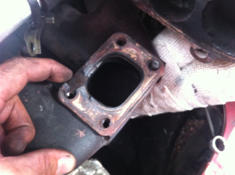

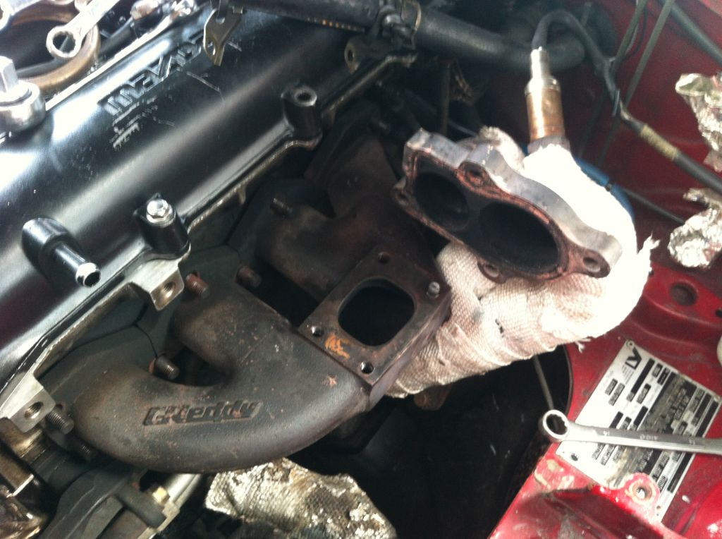

PS: You can see the problem, a busted gasket (FWIW the busted gasket is a fat 3 layer piece whilst my replacement is a skinny single layer one...
Heres what it looks like now, I can't get mani off to take to get stud sorted.
See the drivers side rearward stud is manked, and the thread isn't good in the mani either:(
Here's where the gasket has been blowing through.

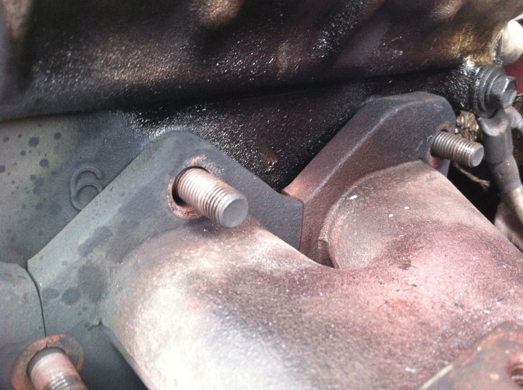

From memory there's 9 studs holding on the turbo manifold, did you get all 9 undone? The stud that's second rear most (ie the next one in from the back of the head, underneath the manifold) also holds the metal coolant hose that goes to your heater core, make sure that isn't what's holding you in there if it's rusted to the stud or something like that.
Post by harlansmart » Wed Apr 04, 2012 1:32 pm
Yip,

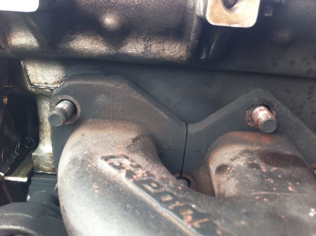

Thanks you for making me go check again but I can see the whole manifold, and can feel all around it there are 9 nuts and all are removed, that coolant-type-looking pipe (goes nowhere) which hangs on a little bracket of the 3rd or 4th stud on back on the bottom row and goes nowhere isn't hindering things, it's all wiggly and lose now the nut is off its stud - also, is there any reason I can't cut that pipe closer it's source... its goes right past the head then is cut & blocked.. about 35cms of worthless pipe it looks to be to me?
Yessiree, pretty sure the mani is stuck because she's jammed against the studs.
I don't want to wreck the studs or manifold they both look great - I'll take a better pic.... here you go...
front studs jammed hard against front edge on manifold holes
rear studs jammed hard against rear edge of manifold holes

If I go and buy some tools do you reckon I can fix this issue in situ?
Post by Euen » Wed Apr 04, 2012 2:23 pm
It could be done in situ but would be a lot easier if you got it out. I had to do a similar job for my son's 180SX at the weekend. Looking at the state of the stud that you have removed, I would say that you will need 4 new ones if the others are like that. You will need to re-tap the holes in the manifold as well. If the holes are blind, you will need a "bottoming" or "plug" tap to get right down to the bottom of the thread. If the threads are really bad you may be looking at fitting helicoils or something similar but it would need an experienced machinist to do that and it is not something you would do in situ.
To get the manifold off you may need to apply leverage at both ends so that the pessure is releatively even along the length of the manifold. This stops it trying to come off the studs at an angle which makes it more difficult.
Sorry to sound so pessimistic but if you want to get the full enjoyment out of it without it breaking every 5 minutes, then you need to fix it properly.

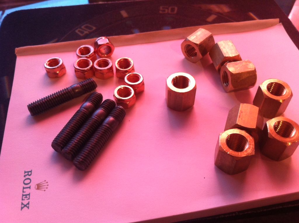

I have the 4 new studs (see piccy below), new metal gasket for the turbo, new 3 layer metal $75 manifold gasket, new $80 Manifold Brass nuts, new copper loc-nuts for these studs and also new copper loc-nuts to hold the back of the turbo together, I 'd not anticipated the studs breaking nor the stud threads being damaged (might have guessed I s'pose sods law) - the 2 front studs are in good condition it's the 2 rears which are screwed.
Ok – have tried again this thing is stuck on... unless I can do it in situ I need to get it off I can't carry the whole MX5 on my bike:(
If I buy some drills and an ezy-out kit and a tap set maybe I can do it here at home.. or will the dump pipe be in the way, its hard to get off due to the bolts locations.
These are Harlans new Brass Manifold Nuts and Copper Turbo nuts and new studs to go on Vader

If you put two nuts back on each stud & lock them together tight it may allow you to unwind a few studs giving you more play to remove the mani!
Post by SLYDIT » Wed Apr 04, 2012 8:39 pm
try wedging a chisel or screw driver in those releif cuts to releive the pressue on the holes.
it looks like the outer ends of the mani have closed in towards the center section.
on my manifold i drilled the outer most holes at 11.5mm (may have even been 12mm) so that the manifold wont bind on the studs.
