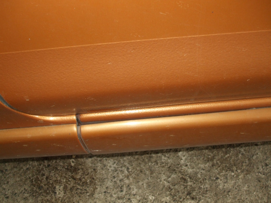

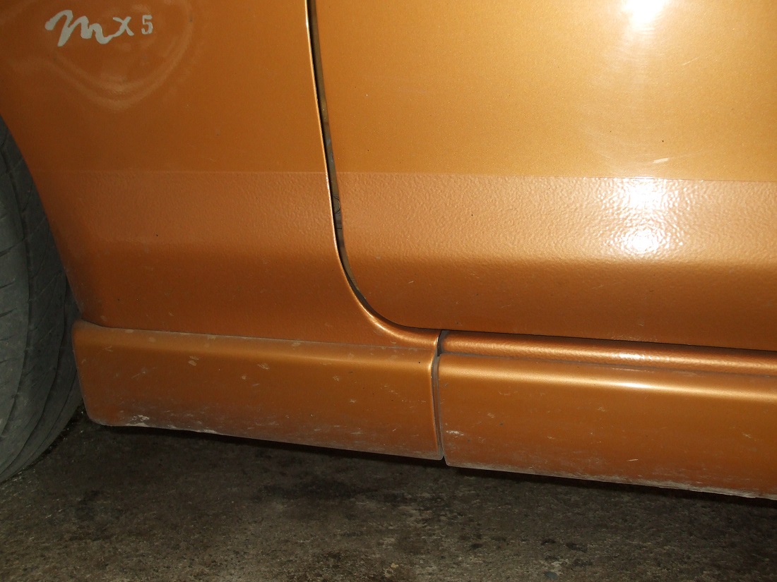

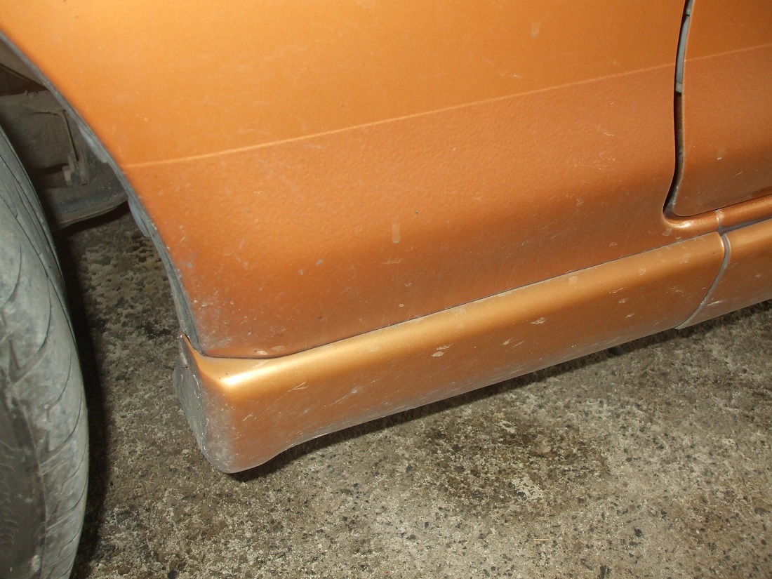

The whole thing is too far 4ward by a few mls causing back 2 kick out and front 2 poke in wheel well - I'd b pissed off with that !!!p
Re: fit of kit
Post by Junkwhale » Tue Feb 25, 2014 11:14 am
2old4this wrote:The whole thing is too far 4ward by a few mls causing back 2 kick out and front 2 poke in wheel well - I'd b pissed off with that !!!p
yeah it's off a few mm in all sorts of places. I think they probably drilled all the holes in the wrong places (trying to make it fit flush with the door) and now it can't really be moved without drilling more holes/making a mess I imagine.
If it was just minor aesthetic imperfection I could deal with it, im kind of concerned now though that the large gaps will just let dust/dirt/leaves in, then it will get rained on and slowly rot/rust through the paint and then panels underneath...

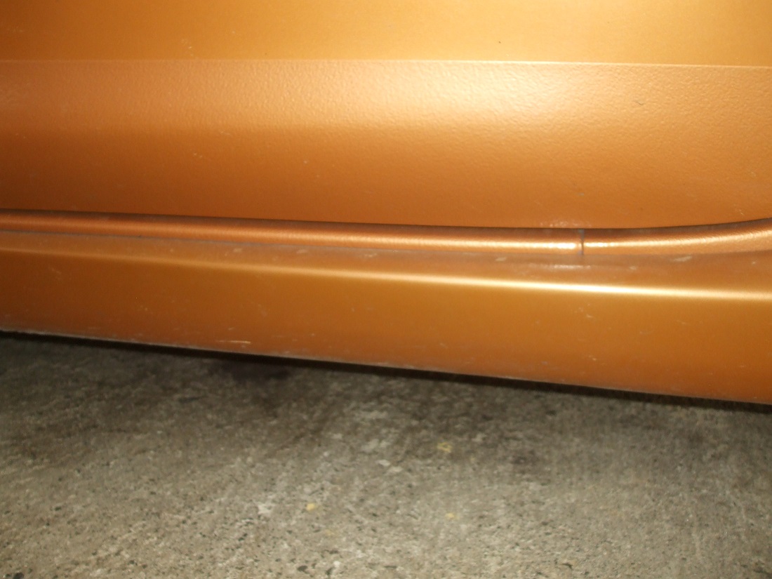

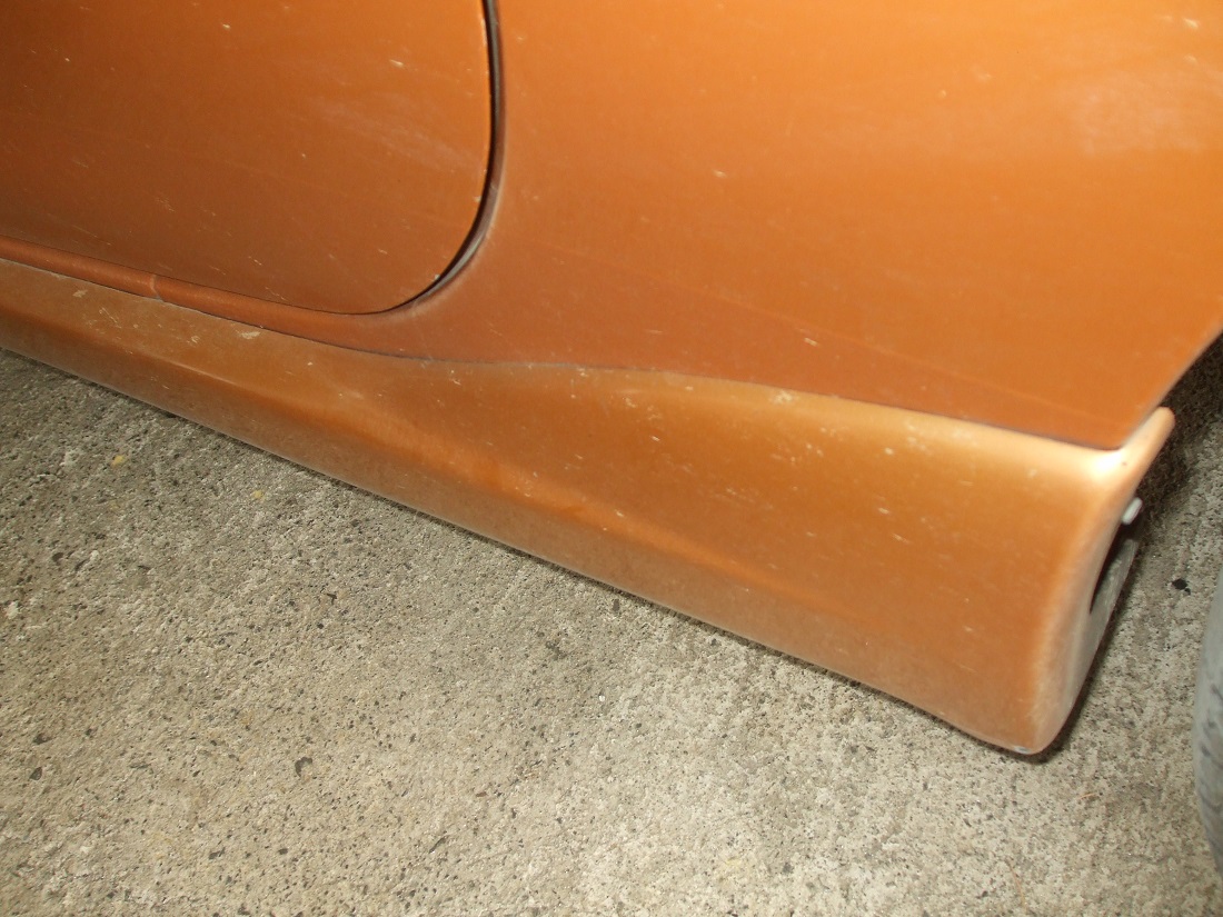

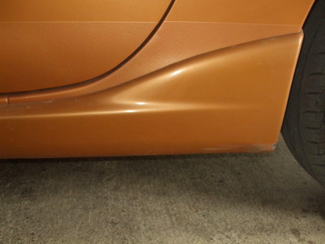

Post by WideOpenThrottle » Thu Feb 27, 2014 5:22 pm
Heres some pics of our one if it helps
Post by WideOpenThrottle » Thu Feb 27, 2014 5:23 pm
and one more
