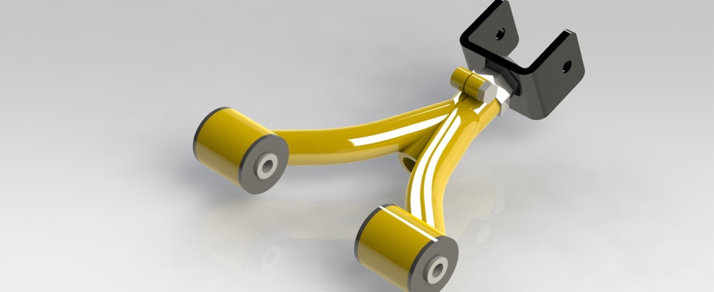

Has anyone found a decent Adjustable camber arm for these vehicles? With the new camber laws its a headache getting any decently lowered MX5's certed.
Platinum Wheels
15 Parkway Drive
Mairangi Bay
09 486 5317
WHEELS, TYRES & SUSPENSION!
www.platinumwheels.co.nz
Post by siren676 » Mon Feb 04, 2013 11:07 pm
In short, no. The ones that are sometimes on trademe are crap, have heard they dont fit properly and get flogged out easily.
Cant say ive seen any other brands
Edit, looked back through a few threads and it seems that offset bushings in the upper control arm would be a good bet.
Post by Kieran » Tue Feb 05, 2013 1:32 pm
tsoob wrote:Has anyone found a decent Adjustable camber arm for these vehicles? With the new camber laws its a headache getting any decently lowered MX5's certed.
There are really only two options extend the RUCA's to add positive camber unlikely to pass cert... if they spot it :P
Otherwise spend over 1K on some DGM RUCA's when they are released
http://clubroadster.net/vb_forum/22-sus ... rucas.html
Post by Furai » Tue Feb 05, 2013 1:40 pm
Cant you get different lower arm bushes that allow more camber correction?
Post by Euen » Tue Feb 05, 2013 3:03 pm
A bit on the pricey side but Flyin Miata stock the V8 Roadsters bottom front arms which have an extra adjuster on the outer knuckle.
http://flyinmiata.com/index.php?deptid= ... %20%20LEFT
On the rear they put the extra adjuster on the top arm.
