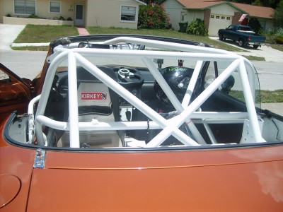

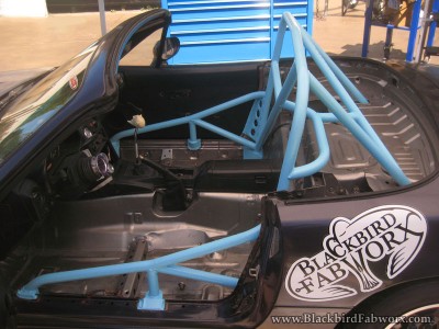

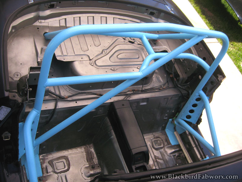

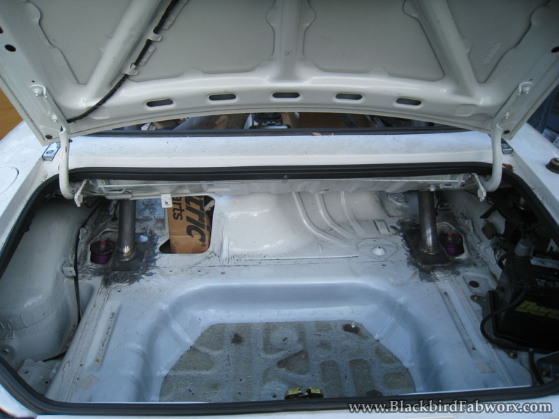

I want to get one made like this

Post by Bwarp » Fri Oct 19, 2012 12:11 pm
You'd never get that legal in NZ because of the door bars. Anything forward of the seats needs cert, and only way to get cert with cage is with homologation and authority card, and to get authority card it needs to be half cage without door bars, or full cage as far as im aware.
The guy building mine also advised under msnz rules the rear stays cant go back further than the rear axle line, which I wasnt aware of.

understandable about the door bars
those rear stays are mounted to the rear strut tower so would be fine as thats level with the rear axle?
Post by Keith Jones » Fri Oct 19, 2012 4:10 pm
Unless they've changed the rules you shouldn't have any problem getting an authority card with a half cage and door bars. That's how mine was for years.
