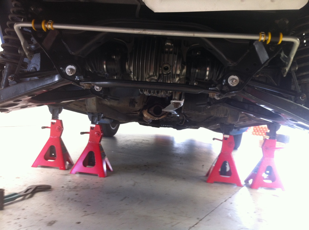

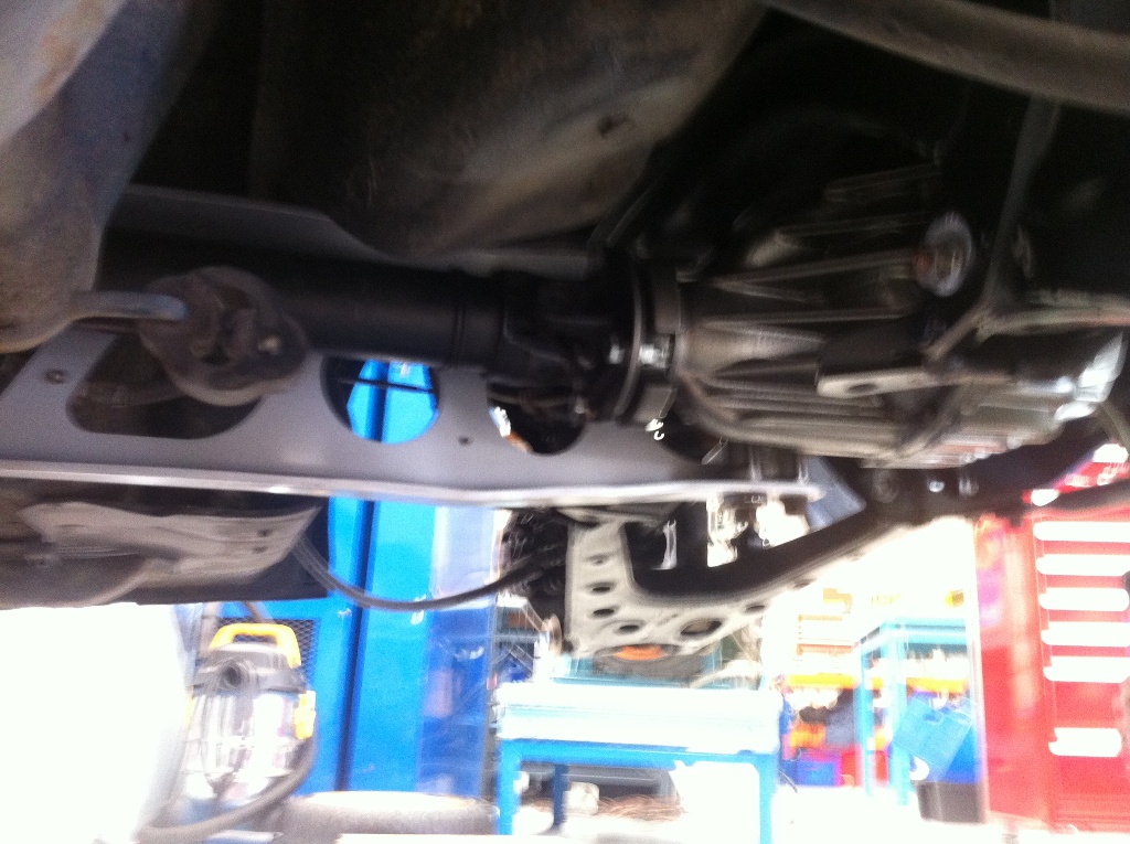

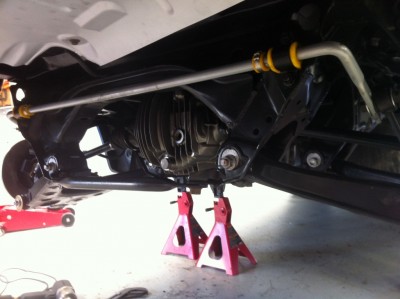

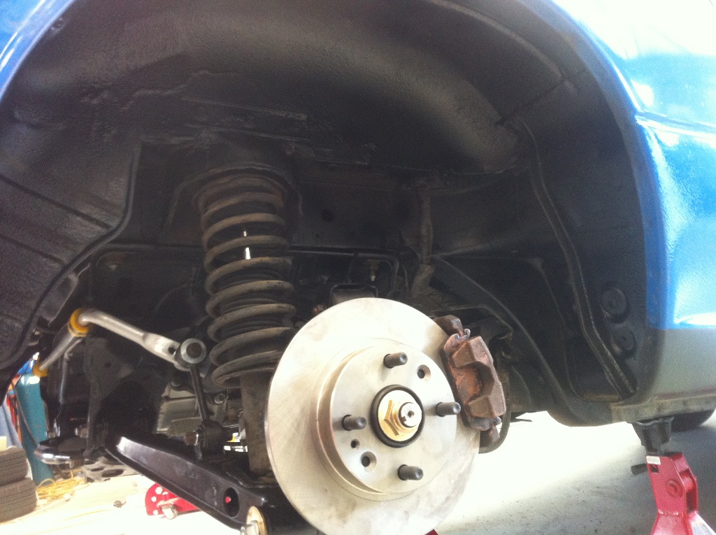

Post by REDBEN » Sun Jan 27, 2013 11:47 pm
New Diff and sub frame are all in, was a bit of a mission but thanks to Kieran and ryanhorton1973 we got it all in by the end of the day on Saturday.
Whiles the old NA6 Rear sub frame was out I took the opportunity to clean under both wheel arches and rear end of the car then laid down some new under body sealer.
After putting the new Diff and energy suspension bushes the car She is a new beast all together. The Diff is super tight and feels really good from only driven 15Km home until Wheel Alignment on Thursday. When purchasing the original sub frame from Mazspares I was unsure of what diff was inside, I opened it up to find a Clutch pack type diff, The diff is super aggressive and feels much like a Lock diff but with out the groans.
The rear Brakes were in a rather sad state so we replaced both rotors and new Bendix Brake pads along with Penrite Racing Brake fluid.
With the new diff in I will be looking to drop into the late 16's on the Quarter Mile before the new motor goes in, in the following months I have changed my plan for the power plant and will be keeping it top secret until later down the year. 8)
Once again Thanks to Ryan and Kieran for their help on Saturday these guys are both right Legends :D
Kieran has pics of the install so hopefully He can post it up :)
