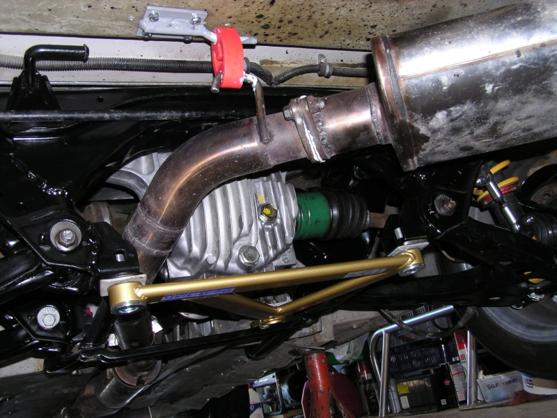

Now that I have received the correct PPF brace (thanks Furai), I finally got it installed today along with the new sway bar end links and exhaust mounts.

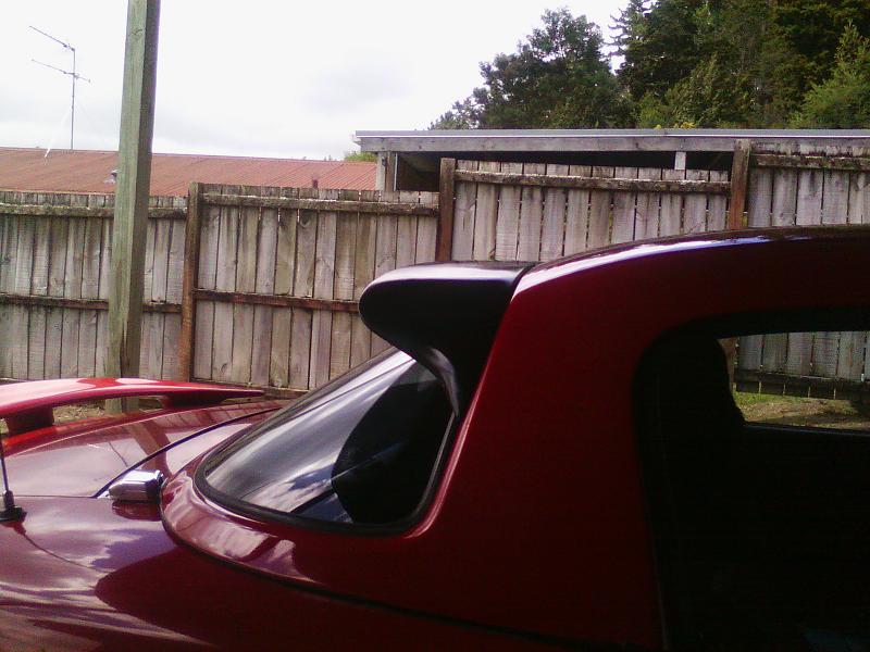

I put on my fibreglass hardtop spoiler today. The spoiler was a pretty good fit but had paint bubbling and dripping marks so I had to first give the top face a sand and repaint. I am no expert but I'm happy with how it came out.
I affixed it using the supplied 3M tape but, (as its a permanent fixture) I used black silicone windscreen sealant on the top edge to seal it off.
I would NOT recommend these spoilers at all.
I strongly urge no one to buy these!
Unfortunately, these spoilers have the nasty side effect of making your car look a hell of a lot cooler and we all know that if usage of these awesome spoilers became more widespread, then the gross median value of 'cool' would devalue based on over saturation of the "mx5's are cool" market.
and that would not be cool.
besides, I wouldn't feel like such a special snowflake if everyone else had one :P

In all seriousness, these are great and they have broken up the lines enough to take away the fat red sausage look my car was rockin'.
(it was worse, the inner mag rims were lipstick red when I got her before I gave them a repaint)
the best advice I can give with them, is if possible drop into your local bunnings and get some of the same sort of tape but wider so you get better coverage. I used the supplied tape and there were enough gaps for me to warrant using an adhesive sealant to aid the spoiler staying in place.
(you only want to seal the top and leave the bottom open for drainage)
you can get away with a sealant if you are cheap like me and go fibreglass instead of carbonfibre but I think sealant would look crap with CF. so in that instance I would buy more of the weatherproof tape.
