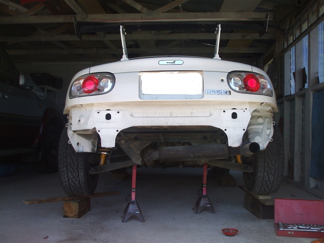

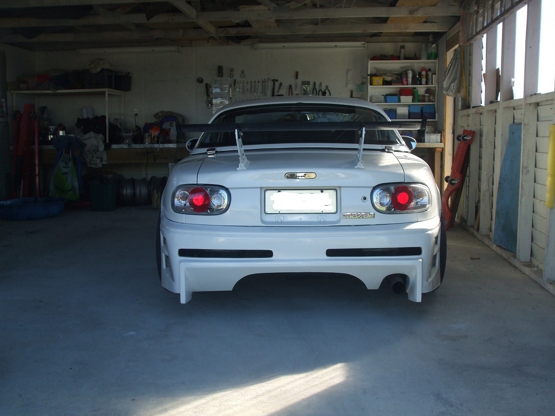

Post by Furai » Tue Jan 01, 2013 12:51 pm
So I had a play around after hitting my brace and decided I need to raise the rear about 15mm.
What it looks like now.
The cause behind it(Notice I have already raised it once)
How it needs to be.
So Im thinking of getting some Alloy pieces cut to spacer the tophat down.
I know some places in the US do them but they are real expensive.
Post by Bwarp » Tue Jan 01, 2013 6:20 pm
Take a decent stencil of your top hat, and take it to a cnc firm. They should be able to cut them out for you easily enough. I assume it just needs to be flat.

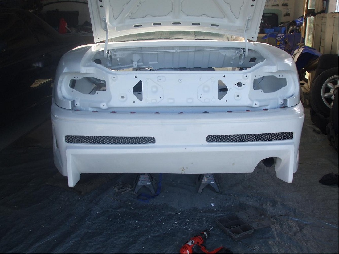

reduced some drag
Post by WideOpenThrottle » Sat Jan 05, 2013 8:46 pm
Been meaning to do this for sometime now.
new shape now
Shape i copied
original
Last edited by WideOpenThrottle on Sat Jan 05, 2013 9:20 pm, edited 1 time in total.
