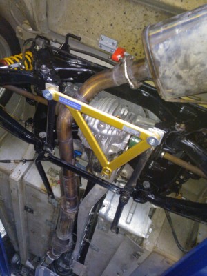

Post by Euen » Tue Nov 25, 2014 2:03 pm
If all else fails, try one of these. Energy or Superpro diff mount bushes also help.
