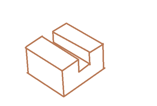

Post by SkilletKid » Fri May 30, 2014 6:09 pm
On jacking:
At home where I don't have much room either side of my car, I jack from the front subframe (near the sump) and the diff. With jack stands in between the rain notches. (my jack is gigantic so I need to drive up on planks of wood to get it under - despite my stock ride height x[ )
When I went to the Ardmore Autocross and changed wheels/tyres there I made a little block to cradle the pinch weld/sill out of some plywood. Jacked one side from the center - change wheels - drop car - repeat for other side. Didn't bend the sill.
Same method can be used for putting the car on stands (placing the stands between the notches as my first method).
Jack block to cradle pinch weld
Jack point.png (7.08 KiB) Viewed 27979 times
