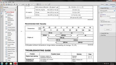

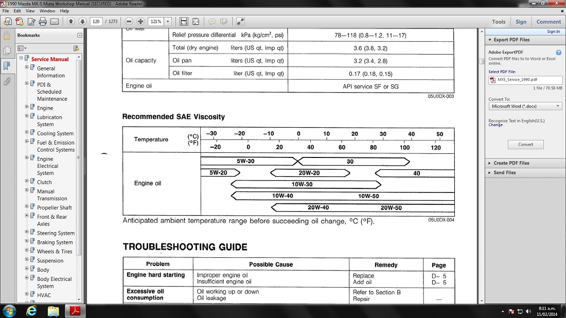

Post by WideOpenThrottle » Tue Feb 11, 2014 8:21 am
I suspect modern low weight engine oils are adding to the fluctuating oil pressures and leaks as they may be too thin for the early NA's.
The service manual indicates that all you need for ambient air temps above minus 10 degrees is a 20-40 or 20-50 oil.
Since changing to 20-50 mine is steady at about 3 on the gauge.
