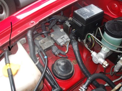

That's the thing though, there's no trace of coolant anywhere near that hole from the overflow bottle or anywhere around the engine for that matter, it's just the hole and that seam that are wet, the rest is bone dry, waterpump went not long after I got the car so that was replaced along with the thermostat. I got a few pics, they turned out pretty crap so bear with me
The second pic is just a close up of the first, that's the front left tyre you can see for reference.
I also checked in the passenger side and that was completely dry, however having a closer look in the drivers side foot well, which was still slightly damp I noticed a tiny spot of green coolant around this plug
Tried to pry it out but didn't really want to budge, any ideas where that goes? As I'm thinking that might lead me to my problem, cheers for the replies dude!
Post by WideOpenThrottle » Sat Jun 08, 2013 8:49 am
That bung is nothing but I still feel the water is travelling from the overflow hose that comes out of the bottle & then running from there.Look at the pics and maybe take out the bottle and see if there is coolant stain anywhere.
