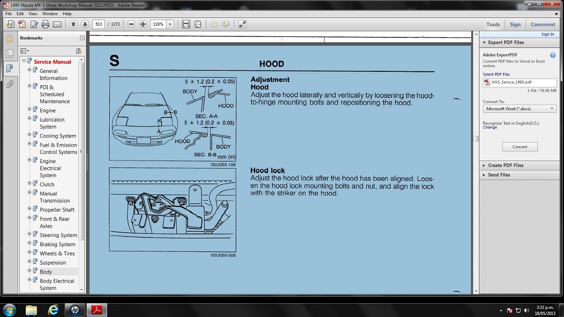

Anyone know how to tighten up the bonnet latch? or replace the striker?
Mines rattling away....might ust jab in some bonnet pins and be done with it :/
BTW what are ISC top hats?
And NVH = Noise vibration harshness?
Post by WideOpenThrottle » Sat May 18, 2013 3:36 pm
Some info
