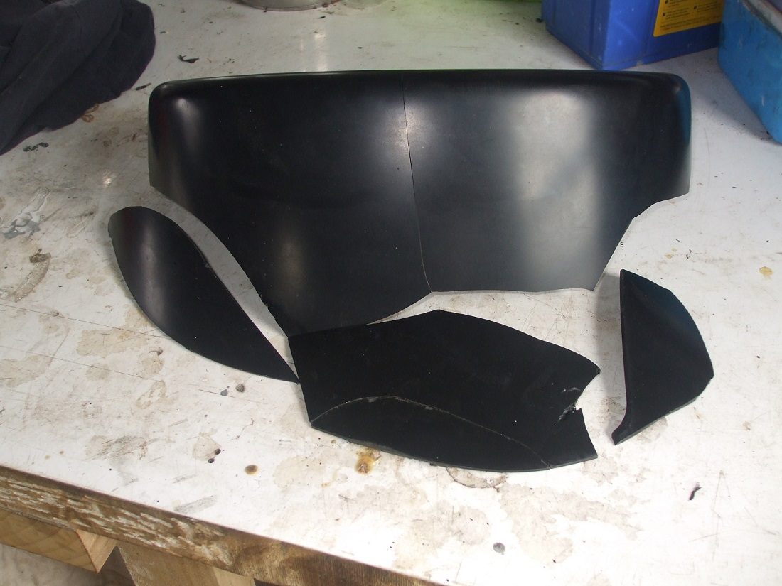

Post by WideOpenThrottle » Sat Mar 30, 2013 12:02 pm
This is what happens when you try to drill some holes for wires in an old cover! :cry:
Next time i will use a soldering iron and melt some holes.
Now to hunt down another.

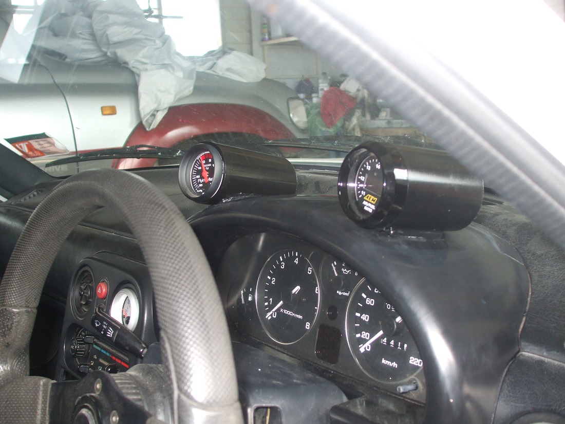

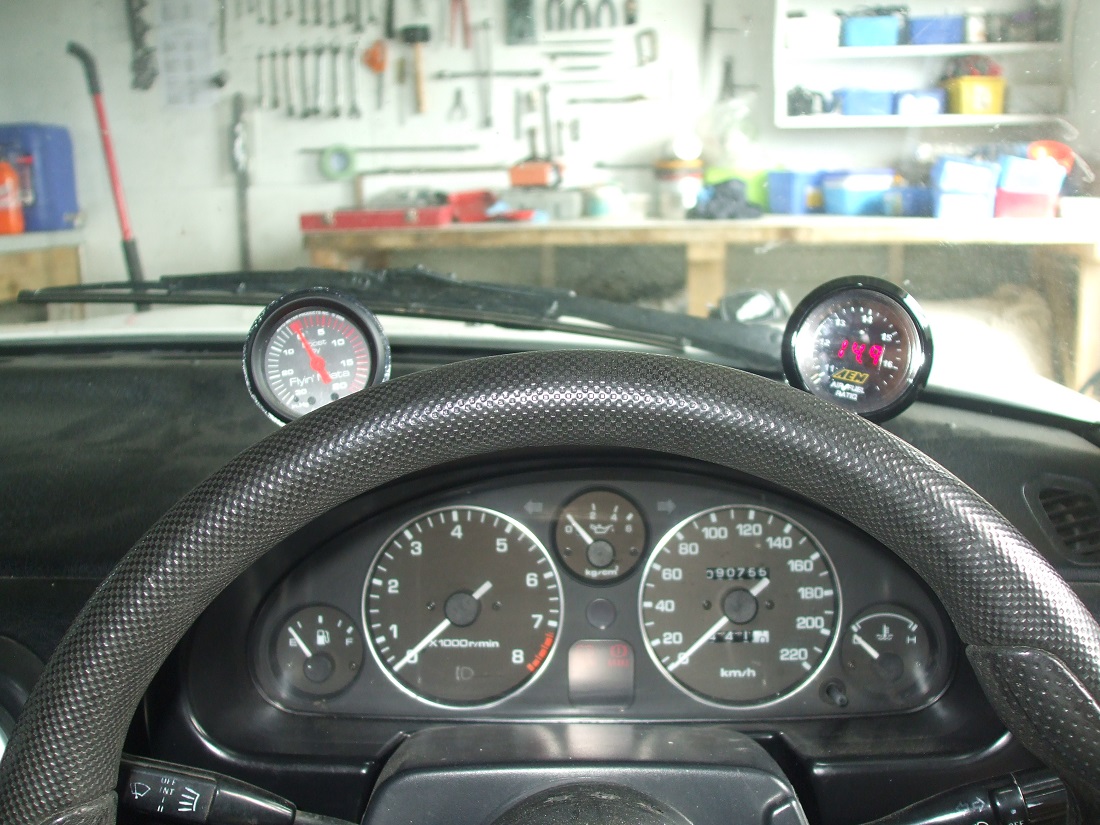

Post by WideOpenThrottle » Wed Apr 03, 2013 1:42 pm
Thanks to Harlan & some pvc plumbing pipe i now have my gauges relocated as planned to the dash cowling & managed to melt the holes for the wires etc succesfully with a soldering iron....[did a test run first with a bit from my shattered one]!

Post by MrGrey » Wed Apr 03, 2013 2:09 pm
great job! looks pretty swish 8)
