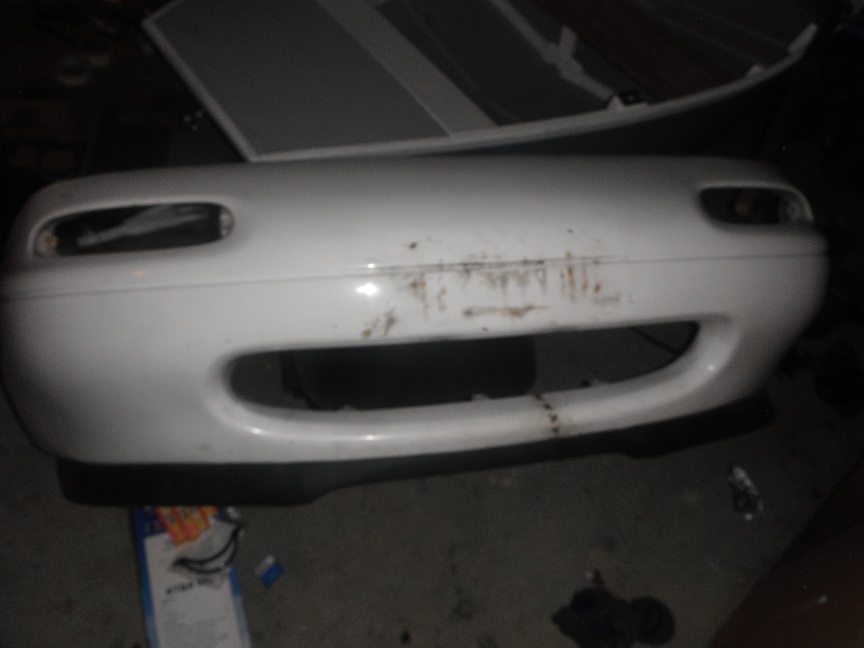

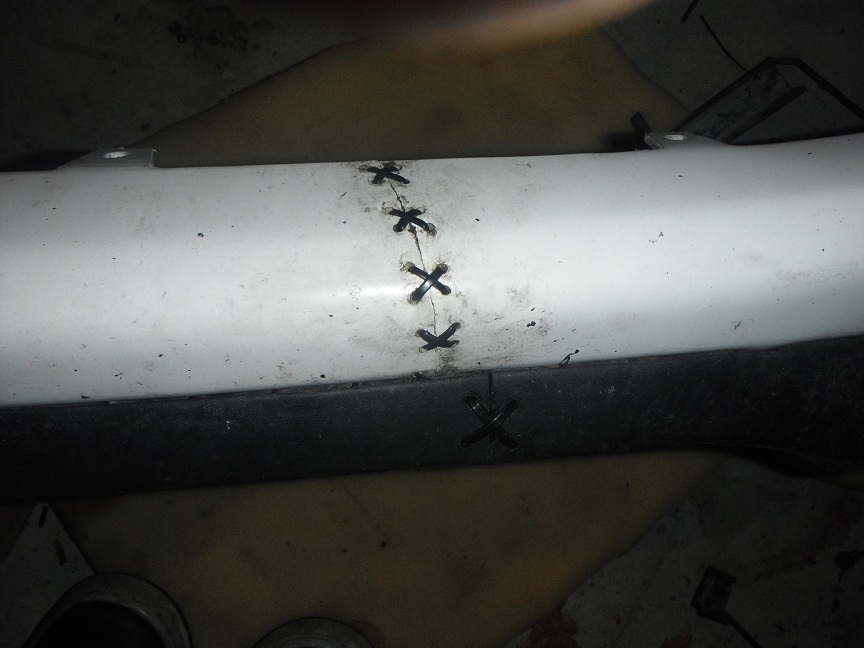

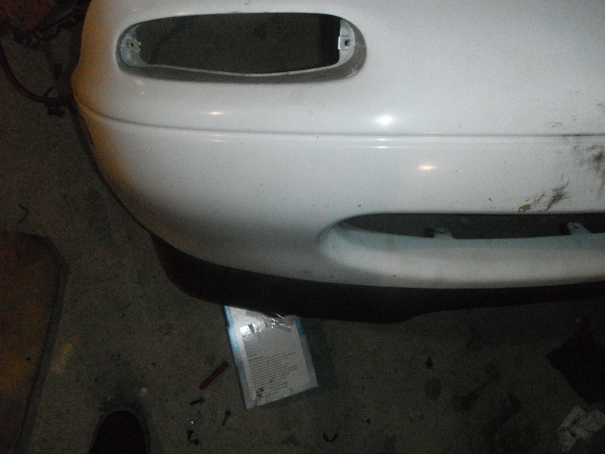

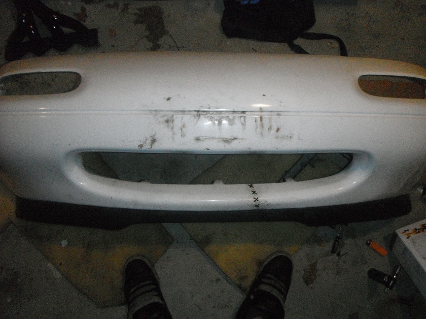

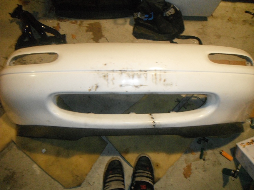

modified a front lip to fit standard bumper

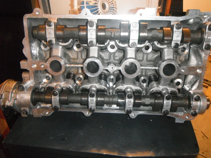

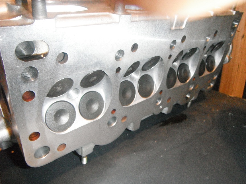

heads port matched, skimmed, new valves and 3 angle seat and assembled.

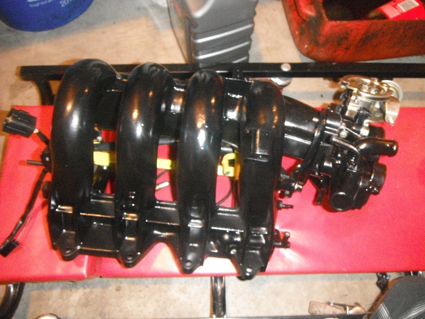

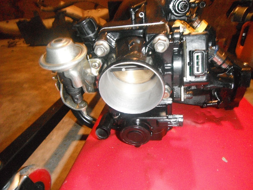

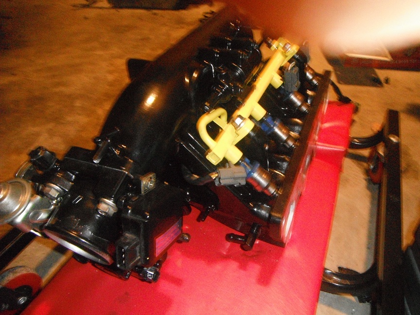

port matched intake to head ports, stripped cleaned painted and assembled

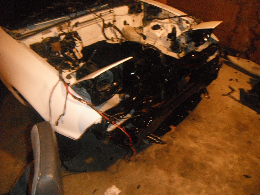

exhaust shield brackets removed smoothed and painted hi temp black

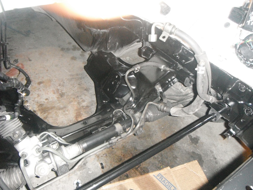

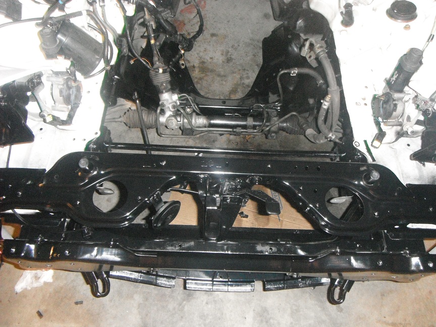

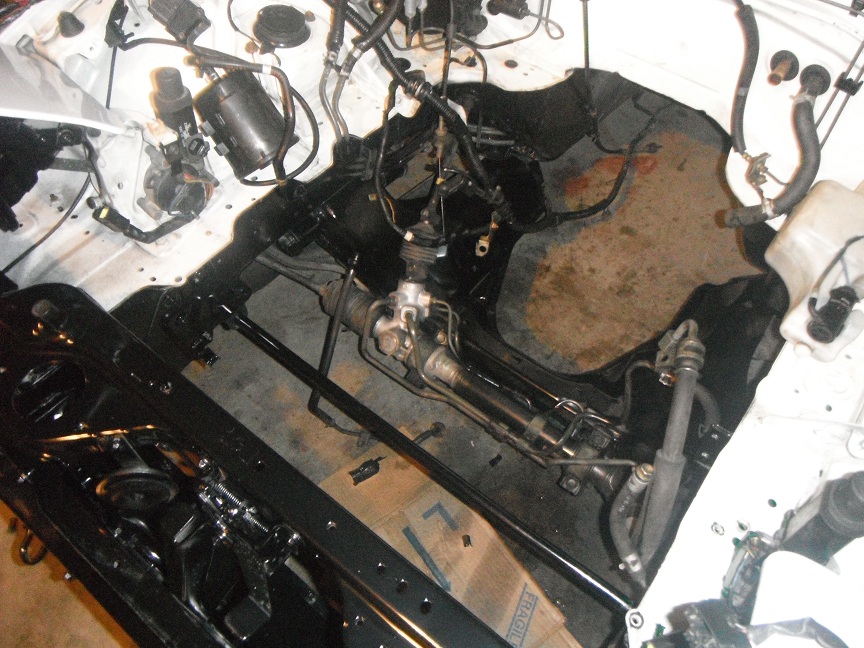

painted engine bay lower half, xmember, front bar and supports and few other bits

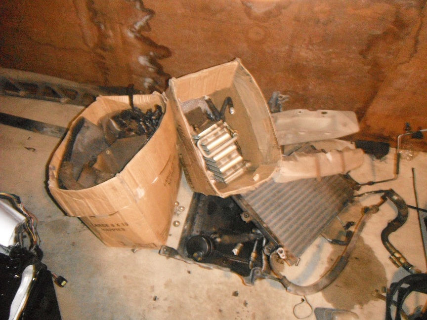

stripped boot completely, removed sound deadening
generally went on a slight diet all over the car

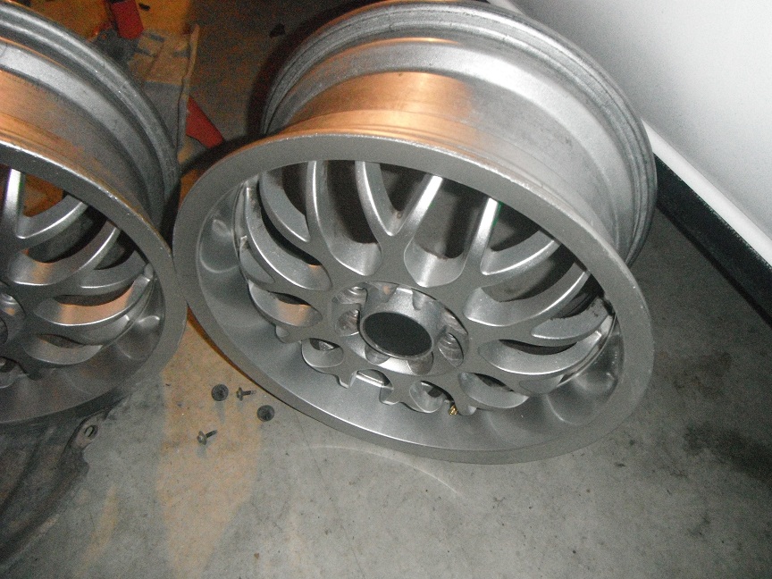

received new wheels
received new wheel nuts/lock nuts

mmm new valves and 3 angle seat
intake
intake
intake

more of the painting this time, getting deloom also atm

more haha take a guess at what i used for the lip, (im not paying 300bux for a lip) haha

and the last of them for now, wheels turned up, and she went on a diet finally aswell
who said males cant sew?

some of the weight loss, there is more but just as an idea haha

il keep this updated anyhow, got the block half done, and o/haul on the box. all in all spent a huge 750 bux so far, not much at all considering its getting a complete rebuild
Post by tomtikki » Sun Aug 26, 2012 10:24 pm
Nice sewing job on the bumper, Frankenstein would be proud. Splitter looks great but no idea what you've grafted to make it.. Go on, whats the trick?

tomtikki wrote:Nice sewing job on the bumper, Frankenstein would be proud. Splitter looks great but no idea what you've grafted to make it.. Go on, whats the trick?
Those rims are gunna look sweet, a quick polish job on the lip would add some bling...
its a p10 primera front bumper lip from factory, bolts up fine, heat it to fit, cut to length and hey hey its done, wheels are probably going satin black tbh, i want some 13s to polish up on the side
