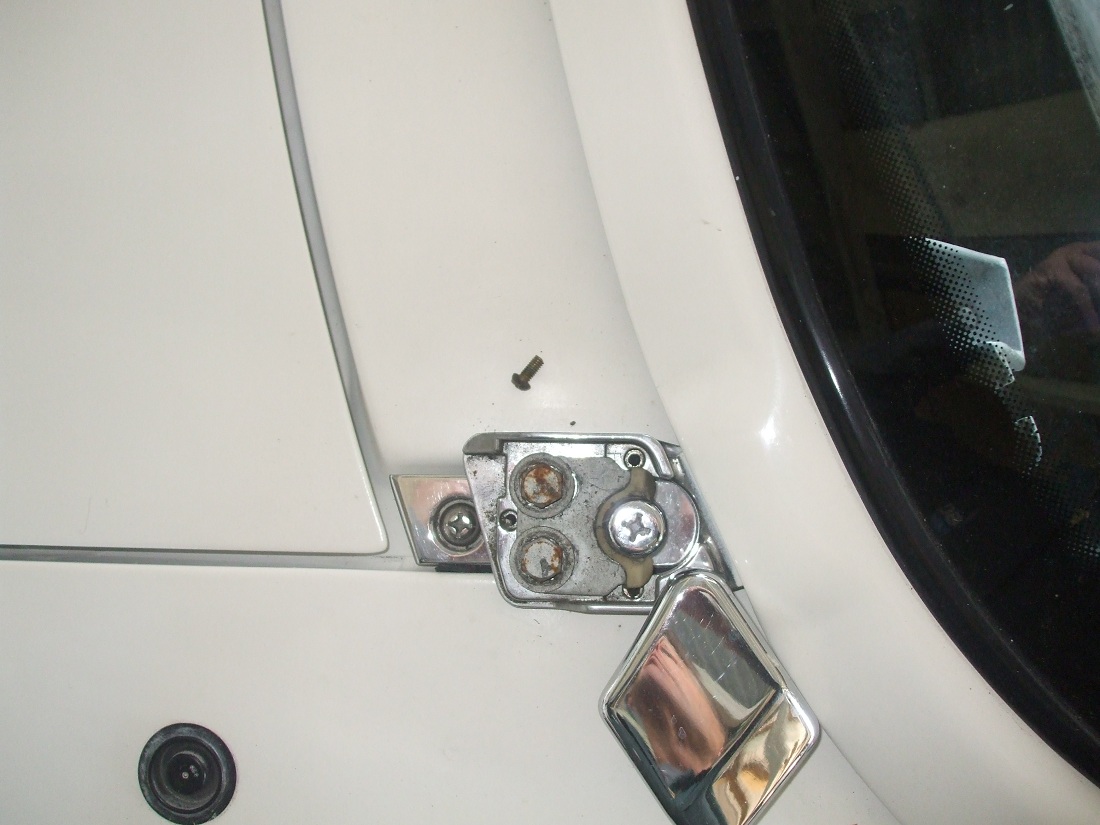

Annoying me for awhile but could never find the source.
Here is what it was...the two bolts under the cap on both sides were loose.
Never knew the cap had bolts under it!.... I do now! & so do you! :D

yes there are wedge shaped plastic blocks screwed in there. you can adjust how tight the rear pulls down by moving or even packing the bocks out.
Post by WideOpenThrottle » Wed Sep 12, 2012 4:45 pm
And slide the plate under the frankenstein bolt first.
