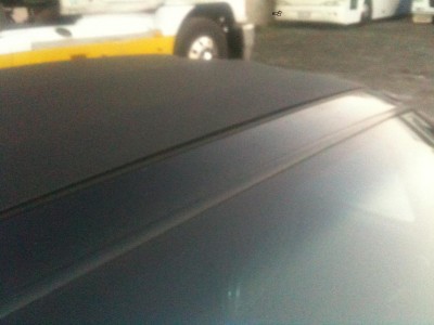

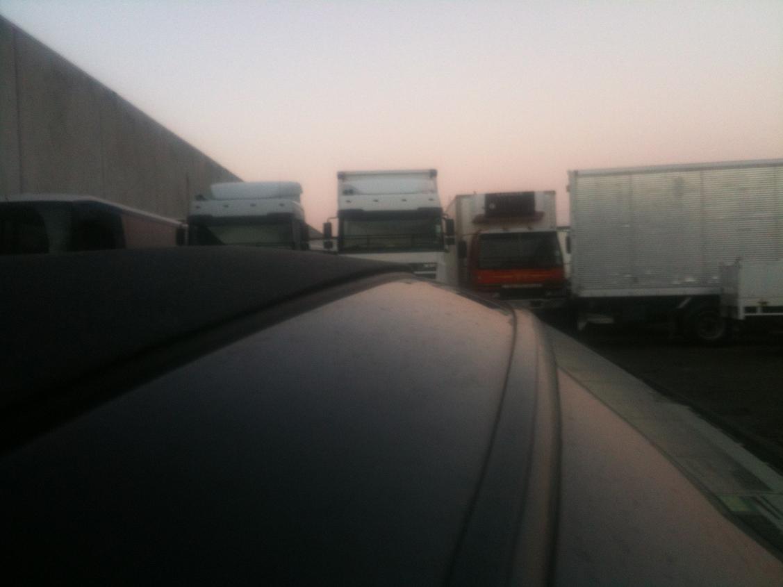

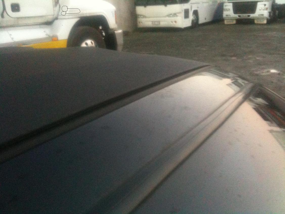

hey y'all. My soft tops not fitting the best and its starting to annoy me. I brought the car about 4 weeks ago and the guy had the new top put on like around then, any ideas how I can fix her up?
Post by warrior » Thu Jul 19, 2012 7:41 pm
hard to tell from the pics...is it sitting to high or not pulling up close enough to the windscreen frame?
dynofiend
Post by dynofiend » Thu Jul 19, 2012 7:51 pm
Looks fine to me?
Post by SLYDIT » Thu Jul 19, 2012 7:57 pm
my old one did that.
i ended up changing roof frames.
Post by Donovan » Fri Jul 20, 2012 8:23 am
Do the clips that hold the frame to the window need adjusting, are they loose when you clip them on, or fairly stiff to press in place?
Post by SLYDIT » Fri Jul 20, 2012 6:44 pm
Donovan wrote:Do the clips that hold the frame to the window need adjusting, are they loose when you clip them on, or fairly stiff to press in place?
no its just a bend in the front rail thats a bit different, no matter how i adjusted the clips it just sat wrong. when i did the top i replaced the frame too.
Post by evel » Fri Jul 20, 2012 8:46 pm
the passengers side latch is as tight as it can go and the drivers side isnt far off. Its seals up alright, I have hit it with the water blaster at work a few times and hasn't let in a drop of water. But over 70k's it can get a bit noisy with wind and if i grab it and pull down the noise stops. can i just bend the frame back or would it be best just to replace the frame?
Post by SLYDIT » Fri Jul 20, 2012 8:52 pm
you could try putting washers under the windscreen frame latches, so that when thesoft top frame locks in to the receivers, it will be a bit lower compared to the windscreen frame.
