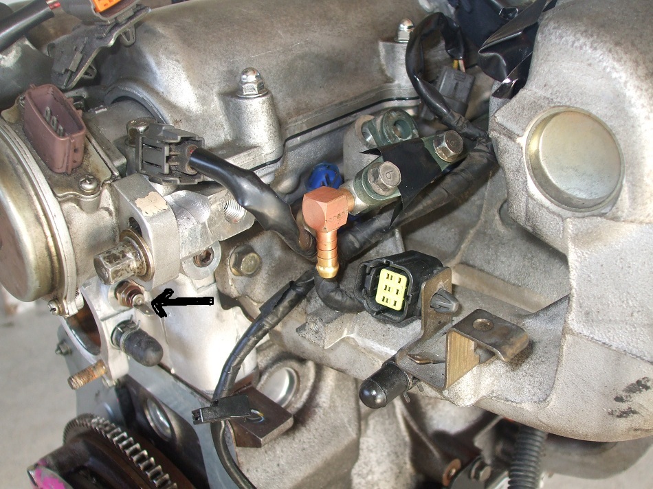

While investigating my coolant re-route options i was curious to know what part this little sensor is used for?
It looks like it senses water or temp but cant find it in my detailed manual.
Post by SLYDIT » Fri May 11, 2012 8:11 pm
pretty sure its for the temp gauge
Post by Keith Jones » Fri May 11, 2012 8:13 pm
It's the coolant sensor for the ECU

Post by last_resort14 » Fri May 11, 2012 8:30 pm
Yea SLYDIT got it, it's just for the gauge, the ecu one is the larger one with the square green plug.
Post by SLYDIT » Fri May 11, 2012 8:31 pm
isnt the ecu one on the rear housing?
last_resort14
Posts: 252
Post by last_resort14 » Fri May 11, 2012 8:43 pm
Yep thats it, in this pic here
The blue arrow is the gauge sensor, the big green square sensor is the ecu one,
The little grey one on the thermostat housing on the front of the motor is just the fan switch.
Post by WideOpenThrottle » Fri May 11, 2012 9:05 pm
Cheers guys...so its got two thermo-sensors-the front is for fan control while the rear is temp gauge so i need to make sure i hook it up again! :D
