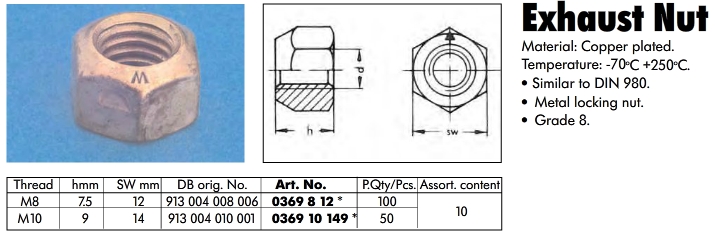

Try and find some copper coated lock nuts for your manifold studs as well. These do not vibrate loose and the copper coating means they don't seize on the stud. I thought that Wurth had them but I cannot see them in their catalogue. I managed to get a few from Al's Mufflers when they were still open and a few more from "The Italian Job" behind Al's. Alternatively you could try the Bolt Shop on Archers Rd.
For the cam cover gasket, I normally get mine from BNT, haven't had a bad one yet. Just make sure you put a dab of sealant in the sharp corners. Also as mentioned earlier, make sure you get the stainless exhaust gasket. The multi-layer aluminium ones will burn out.
Edit: Had another look and found on page A05-114 of Wurth's online catalogue.
Only problem is it looks like they may only sell in packs of 100 for M8 and 50 for M10. I suppose if you could get a group buy for 4 or 5 people it may be OK.
