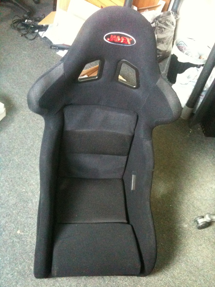

Have managed to get a pair of Jamex Seats and harnesses. Not FIA approved, but good enough to hold my skinny white butt in the seat when taking it around the track. Last time out when the car was running, had to brace myself in with one knee up against the door, and the other knee against the centre console.
Not a good look, and a few bruises afterwards.

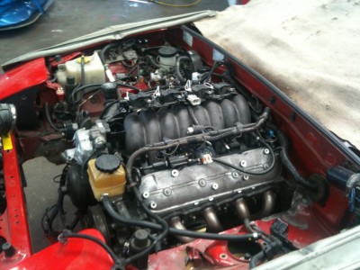

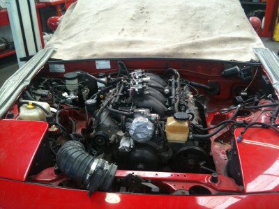

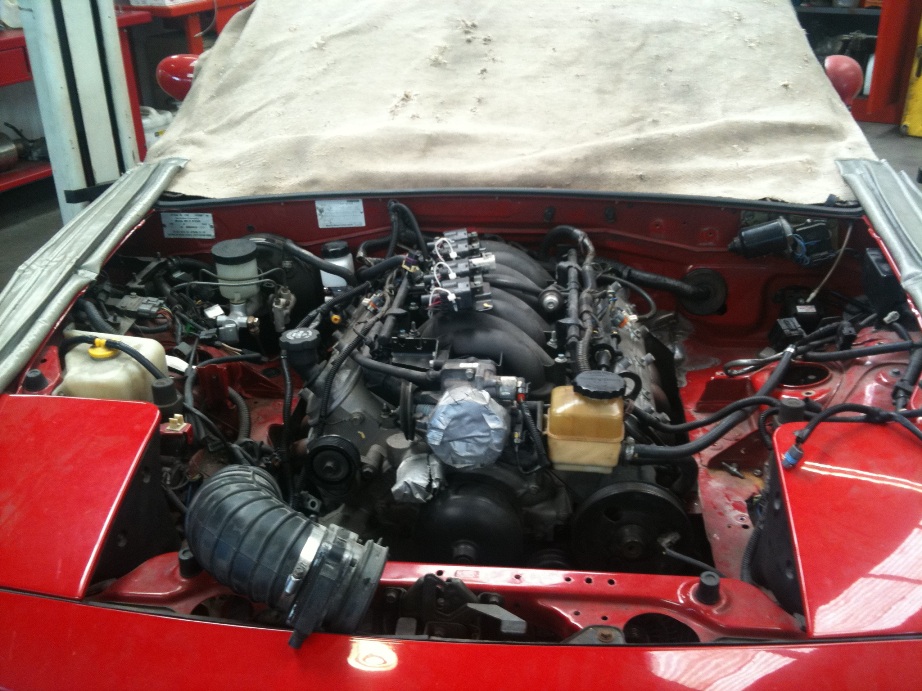

Another visit to the chop shop last week, expecting to see not much happened, and well what do you know, there is a little MX-5 with a big bit of alloy sitting in the engine bay. And a diff mounted in the rear subframe as well. And axles and drive shaft almost done.
OMG, OMG, OMG, starting to get excited again, like a giddy little school girl.
ETA for being on the road is before end of November.

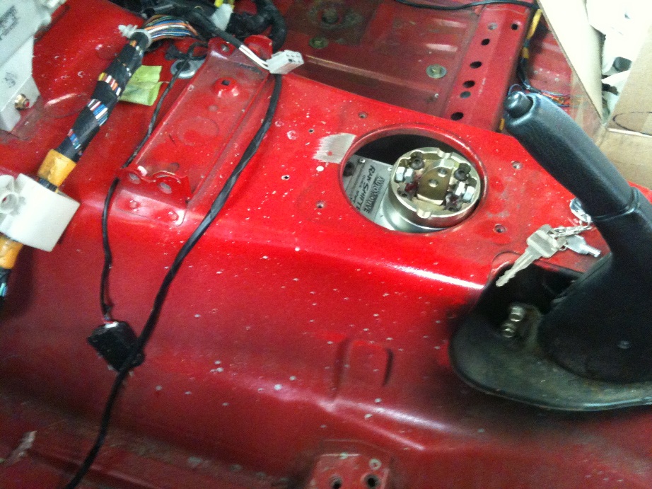

Header have to be HPC, engine bay needs to be sprayed, radiator fabricated, and wiring done, otherwise, almost there. Oh, and apparently the boot space is going to be filled up with swirl tank etc for fuel. Guess nothing is going to be going in the boot anymore.

see if you can get them to fab the swirl tank along side the main tank just in front of the strutt tops...that way you won't lose boot space.
i am talking about that space that hides behind the cover panel that houses the jack handle etc...

Haven't seen the car for a little while now, the last time was when I went down to pick up the Jamex seats, as they wouldn't fit. Apparently the larger size do, not the ones with the narrow bum. The medium size seat is 10mm bigger in the bum, but 30mm narrower in the shoulder, go figure. The problem that I now have, is because the transmission tunnel is wider to take the T56, that the movement of the seat forward is going be restricted, so no short arses will be driving it.

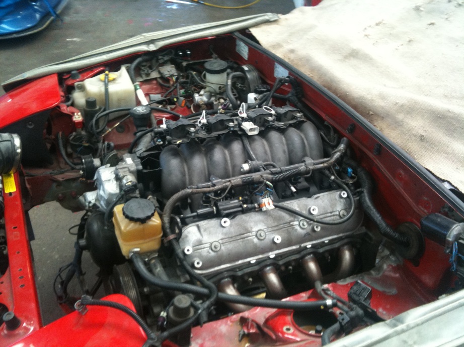

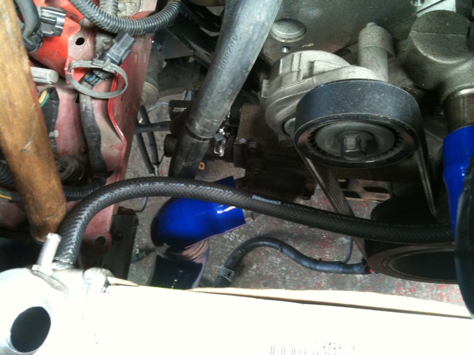

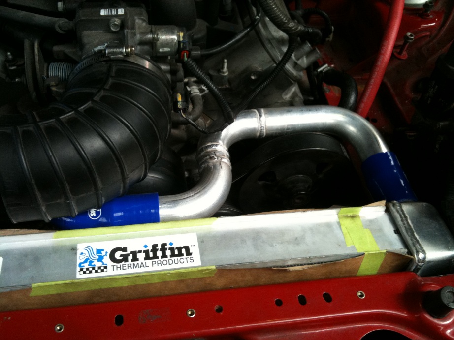

Well, it at least has a radiator. Have had to order intake kit from Flynin Miata, as bonnet wouldn't shut with any of the hoses that we tried using, bum.

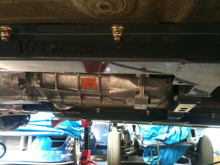

Post by Donovan » Wed Dec 21, 2011 10:32 pm
And this is what is underneath that very short shifter

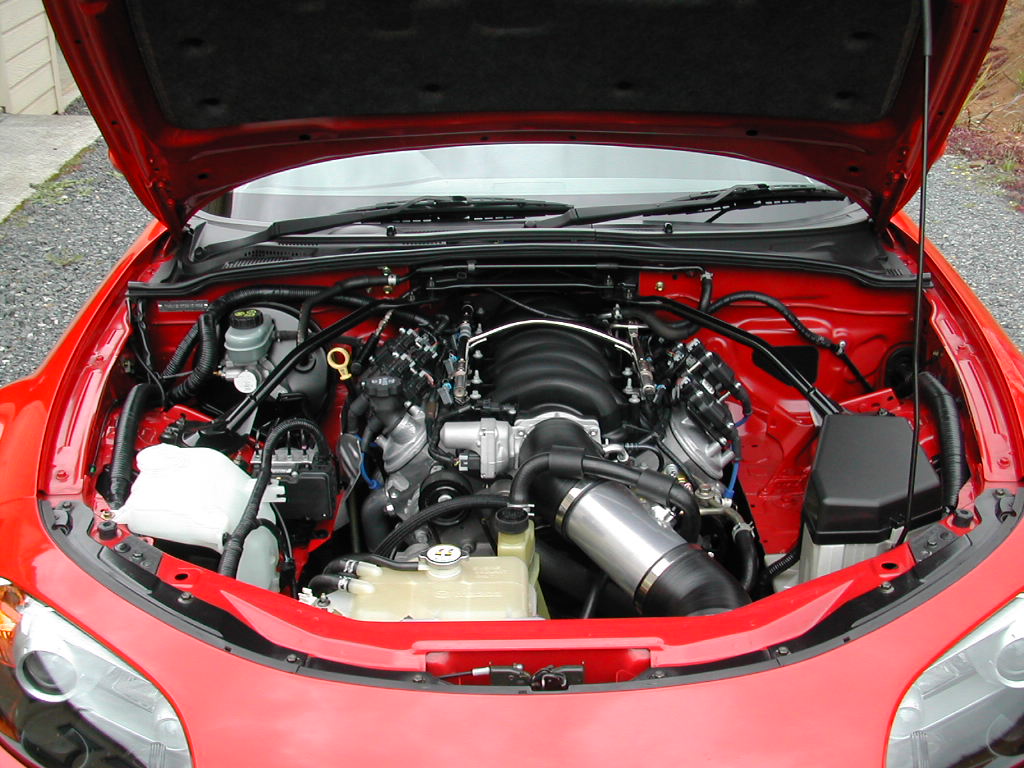

Someone else has done it, 6.5 litre and 6 speed, NZ car, and it can fly!

fleet1 wrote:Someone else has done it, 6.5 litre and 6 speed, NZ car, and it can fly!
It's actually a 6.2 LS3, and you can read a bit more about it in a previous post of mine (link below), plus that post has a link to a US forum site with the full build process in it.
At last time I read about it, it still had the original MX5 diff/axles etc, and this will be where mine is different, that it will have the HSV LSD diff and axles, so will be build more to drive in anger on the track.
