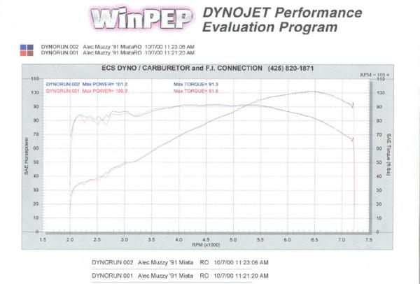

Skilfil wrote:Is it in my head or does shifting at 6500 seem to be quicker? Feels like the car isn't really gaining anything from revving right out to 7000. (1.6)
Also, are you guys talking 1.6 or 1.8?
Its because you want to keep your revs between your peak torque rpm and your peak power rpm
Ive attached a dyno for a stock 1.6 and by looking at that i would keep the revs above 4 and shift at 6.5 after 6.5 the power and torque drop off quick
Post by Skilfil » Mon Dec 05, 2011 4:49 pm
Ah right, I live out on country roads so sometimes get the opportunity to test it out. It certainly seemed to hit 100 quicker shifting at 6500. Good to see some proof.
Post by Kieran » Tue Dec 06, 2011 9:30 am
Yeah I have a 1.8 6 speed so my torque band is a little different but i find i like to keep my rpm above 3K and shift at 6K for the best acceleration anything above 6K is pointless unless you have a free flow exhaust, good intake and higher duration cams but usually the stock head cant flow enough air at that high rpm anyway so unless you have a built motor dont bother redlining any gear its not helping you just use the gears.

In theory you want to shift at whatever point is going to maximise the area under the horsepower graph. In the graph above that would be at the redline.
Having said that, I agree that short shifting has little impact on the fun and quite a big impact on temperatures so it's not a bad compromise.
