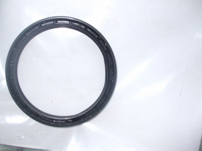

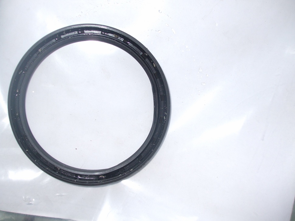

Post by WideOpenThrottle » Wed Jul 13, 2011 3:17 pm
Got bored today so pulled out the gearbox,put the muffler back on & ran the engine till warm, shut it down & then took clutch & flywheel off.
The oil pan rear seal looked fine so i whipped out the newish rear main crank seal & low & behold there was a deformed inside lip [right hand side of pic] which somehow must have folded over slightly during installation!.....here's hoping a new seal carefully put back in will cure the leak!
