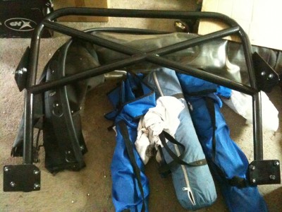

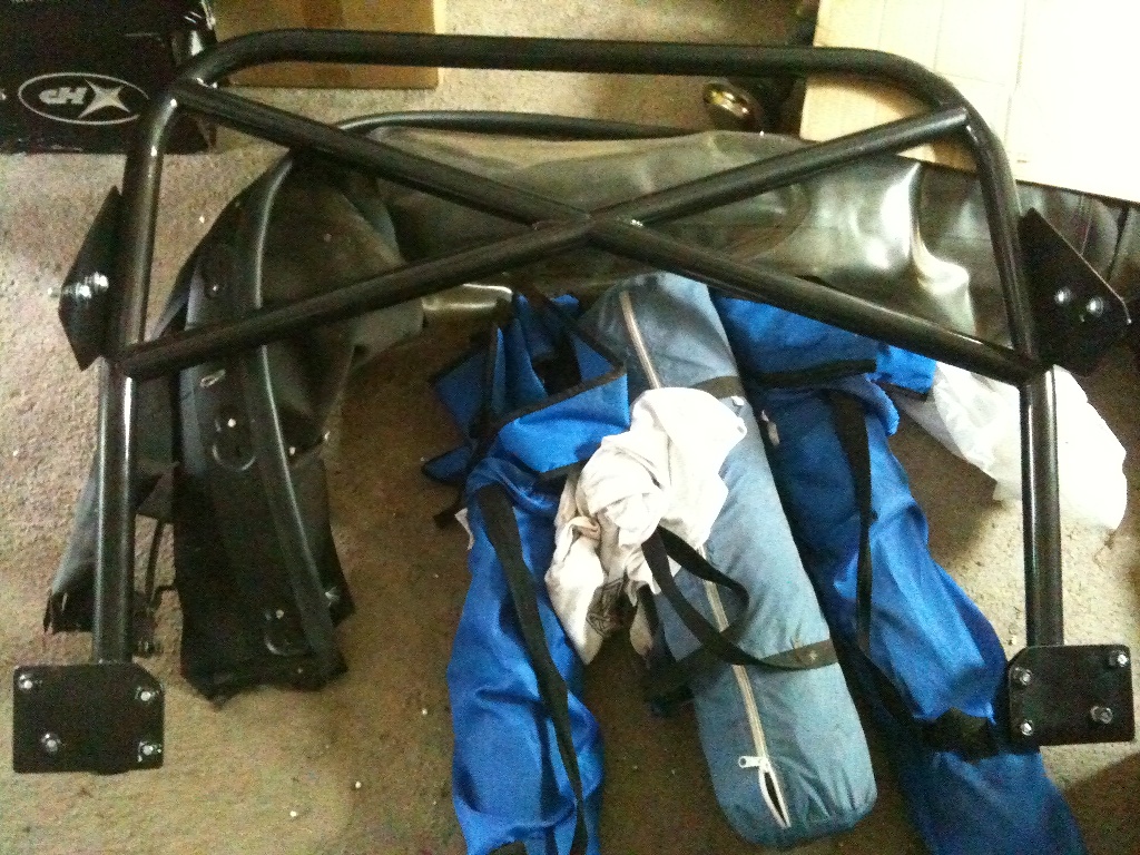

I did buy one which looked identical at a glance to the bar I had in my previous MX5 (photo below), but once mounted sits ~100mm further forward and also narrower, which limits my seat movement and puts it too close to my head. Would happily sell it to a shorter MX5 owner though.

Ben touches on a very important point in regard to clearances. MSNZ specs define the required clearances of the bars from a helmet clad head. For a tall driver in a 5 it is not easy to get that clearance and still be able to have the top closed. One way to do it is to drop the seat right down to the floor.
