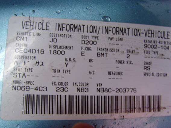

Hi there,
Finally got back home and picked up the 2002 Mazda MX-5 I'd agreed to purchase three weeks earlier. Exactly as advertised by Steve from New Plymouth - so off I set to drive the 700km south to Christchurch. An eventful baptism to MX-5 driving - we had storms all the way with 14mtr swells on the inter-island ferry (car was caked in salt following morning) Gales of over 100kph and a rock-fall that took out the front offside Yokohama DNA dB with a great gash in the wall. Eventually made it home and washed the salt off, then took a closer look at what I'd actually bought.
Apart from the brace in the engine bay, which I'd seen in the original ad and Steve had listed as 'aftermarket', there were a whole swag of other mods including more stiffening in boot (trunk), stiffening ladder under diff, Bilstein shocks, 16" wheels and large fron brake disc, up-rated sway bars and front bar etc . . .
The door sticker stated:-
Grade - Special Edition RS
Katasiki Ruibetsu 9002-104
Model Spec N069-4C3
and the VIN stated NB8C-203775
Now I've tried to search the VIN to find out a little more about this car without success, and I can't seem to find any reference to RS Special Editions.
Any assistance appreciated - incidentally, it's a fabulous machine!

Sounds like a nice car.
If you haven't already found it, there is a wealth of information on miata.net and the associated forum.
If you speak nicely to your local Mazda parts guys, they can retrieve the basic spec of your car when it left the factory from your VIN.
You mention ladder braces under the diff, the NB had a set of braces on the rear sub frame as standard. 2 longitudinal bars that run from the floor pan, back to 2 points on each side, front and rear of the subframe. These points are also tied together with lateral bars. There should also be a similar subframe brace across the rear of the front subframe.
Some of the later NBs also came with larger "sport brakes" and Bilsteins as standard and this could be one of those.
Enjoy!

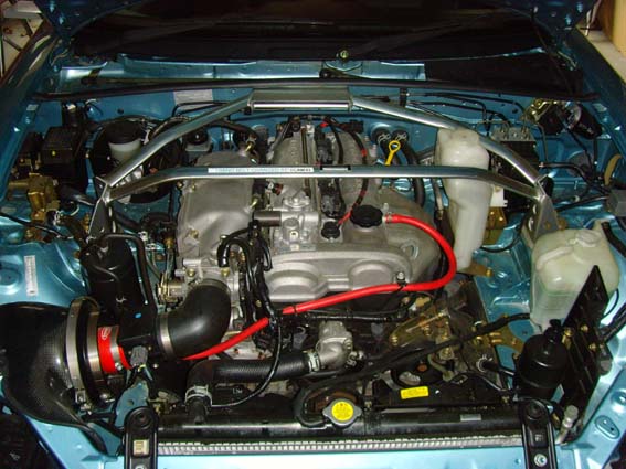

Very interesting. That is some serious bracing and I am pretty sure that none of it is standard fitting. Someone more knowledgable on the NB may be able to provide more info.
It also looks like you have a non-standard cold air intake as well. Most 5s have the intake and filter box on the exhaust side of the engine. It would be interesting to know what else has been done to the car. Does it still have the original computer or has that been changed as well? (Usually located in passenger foot well)
Euen,
I've attached a pic taken off the Mazda website of a MX-5 they had on their stand at the 2001 Tokyo Motor Show showing exactly the same engine bracing and cold air-intake as on mine - hence the thought that all of this kit formed a Japanese RS Special Edition package?
Eric

being the rs you should also have the torsen diff also as standard
any of the braces on the car that are shiny or coloured (not black) more than likely will be aftermarket
