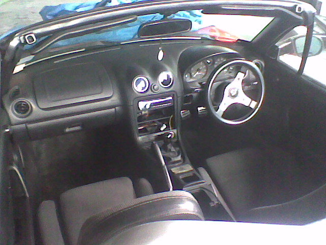

Post by sprsta » Thu Oct 15, 2009 9:41 pm
old pic without the heater controlls connected but you get the idea
Post by brownie » Thu Oct 15, 2009 11:16 pm
What did you do about the L/H airbag set up?
Post by sprsta » Fri Oct 16, 2009 7:08 am
took the cover off the airbag and cliped it back onto the dash
one day i might turn it into a second glove box there is heaps of room behind it
