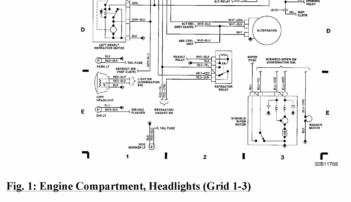

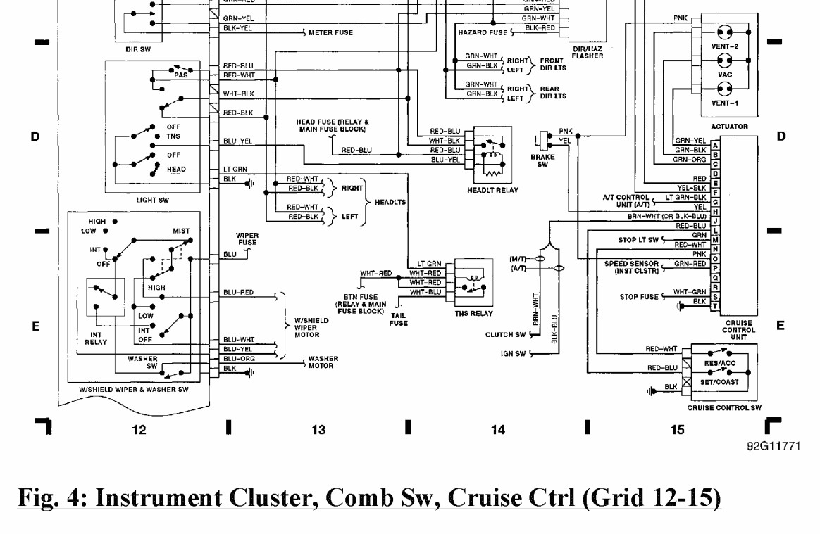

It looks like the washer motor is powered directly from the WIPER fuse. The motor is power side switched by the stalk -- no relay to run the washer pump.
The washer motor has controlled power on the blue/orange wire, and ground on the black.
Attached are relevant wiring diagrams for a '91

Just noticed you said neither the washer nor wipers come on when you pull stalk. It's probably not the pump, I'd be focusing on the stalk.
