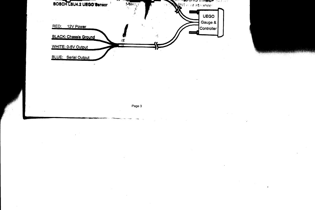

Mine is a four wire and I installed it like this..
Red= +12v
Black= ground
White connects to the single wire,was black in my car [connector by the cas] from the old sensor that goes to the ecu
Blue is used for aux datalogging such as lap-top if required.

Post by WideOpenThrottle » Mon Dec 30, 2013 1:35 pm
Perhaps you need to explain my limited o2 sensor knowledge! :D
2low2c
Posts: 153
Location: north shore
Post by 2low2c » Mon Dec 30, 2013 2:08 pm
ok that is a wideband gauge\controler not a narrow band 4 wire, your actual sensor is a 5 wire

2low2c wrote:ok that is a wideband gauge\controler not a narrow band 4 wire, your actual sensor is a 5 wire
So whats the 5th wire?
Post by WideOpenThrottle » Mon Dec 30, 2013 4:11 pm
warrior wrote:Thanks, any advantage/dis with going to a 3 wire?
and if I had to go to a four wire where does there extra wire go to?
As I posted earlier the 4th is for an auxiliary input such as laptop,etc. if you are in to that sort of thing.
2low2c
Posts: 153
Post by 2low2c » Mon Dec 30, 2013 4:25 pm
a narrow band sensor has 1,3or 4 wires , 1wire is not heated,a 3 wire is heated and asignal ,a 4 wire is heated has a sgnal and a signal earth more acurat than a 3 wire .
a wide band sensor is heated, a signal out,a signal ground and a 5v in.
W O T you are looking at the gauge out puts not the sensor .
