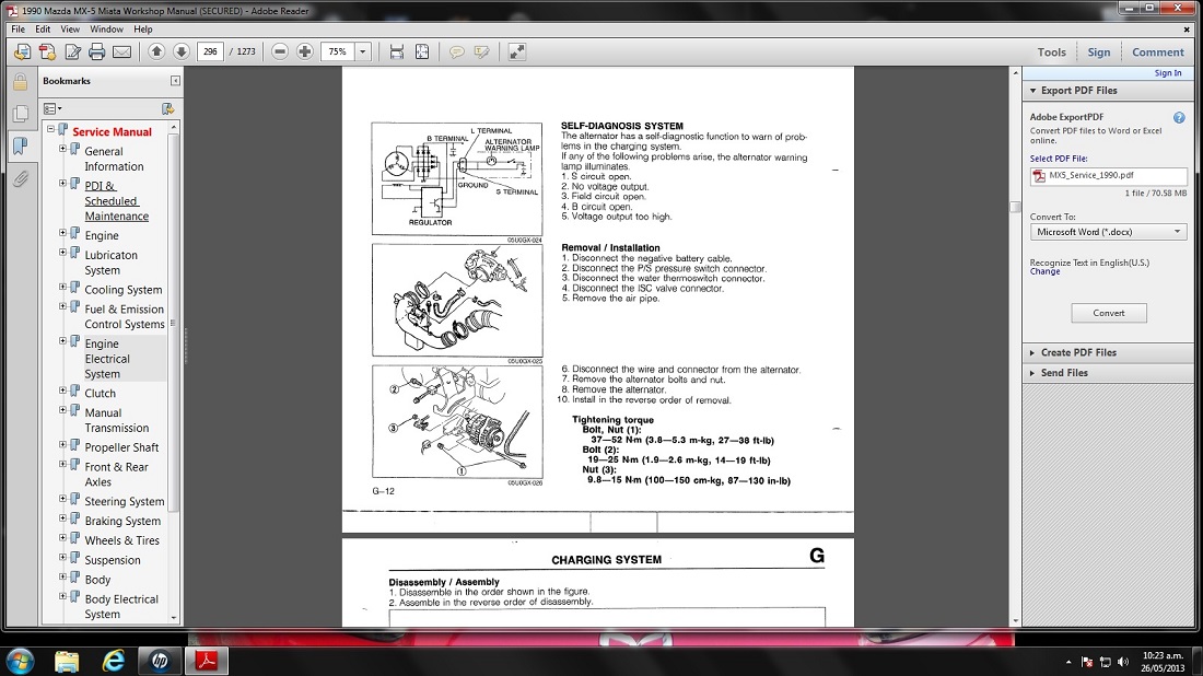

I need to remove my alternator as it is not charging. Had warning light flash up other day and went away with a rev. Couple days later could hear belt screech a little. Yesterday went for drive to warm oils so could do diff and gearbox oil change. warning light came on and stayed on.Got home and adjusted tension on belt. Checked again this morning and alternator not charging. Used multimeter and voltage about 11.5 volts when running. Suspect rectifier gone in alternator.... Is it easiest to remove from beneath the car or from the top. Maybe remove alloy brace like when accessing oil filter?? Any hints greatly appreciated thanks.
