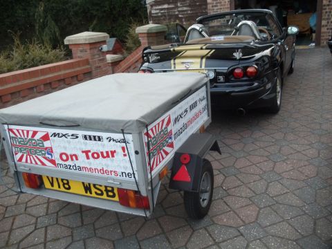

Post by Mazda-mender » Fri Dec 27, 2013 11:59 pm
I have tow bars on a Mk 1 and Mk 2 of mine, and even with the ones i have fitted for other owners here I have just tapped into the wiring, but they have been lead loaded(soldered) in rather than snap clips, do not trust snap clips soldering in is more permenant conection with electric tape or heat shrink tubes, and i have never had or others any problems and mine have been on for many many years buddy.

Post by Mazda-mender » Sat Dec 28, 2013 12:51 am
Merette rear units,(French) the new versions are now done and on sale again with LED units in them, sorry i still cannot post a link? but UK e-bay item No-
