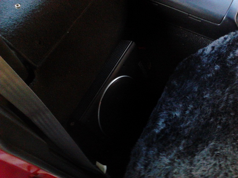

my 1990 mx5 has 2 speakers in the headrest, but a later model of the mx5 also had an 8" mounted in the back of the seat itself. I am unsure how much work would be involved in this as you may need to add additional mounting brackets once you cut open the back of the seat. I have no idea if these 8" speakers where individually amplified.
for your consideration, I have attached a crappy pic of my setup. sorry its so dark, I don't know how to brighten it up (I don't have PS on this PC)

That looks nice. May go for one. How much does it affect the movement of the seat ( does it go all the way back still? ). I have taken the car apart today and it was not that difficult to remove the metal shelf ( about an hours work ) and I am not convinced that you would get a good enough fit to make an airtight seal and also that the space where I was planning on putting the amp is much smaller than I thought. Thanks for the replies to this post, much appreciated.

Post by MrGrey » Thu Apr 25, 2013 6:56 pm
I am pretty sure the seat goes all the way back (or at least damn close) the amp is about 80mm thick and doesn't affect my driving seat position (I'm something like 5'7"-5'8") but I would put it behind the passengers seat if you are one of those people that like to have the seat all the way back. if you can find something of similar size/thickness (like the old yellow pages phone book) then you could do a spacial test fit.
