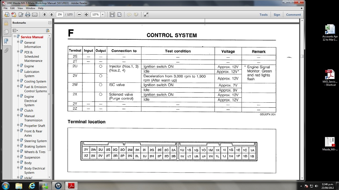

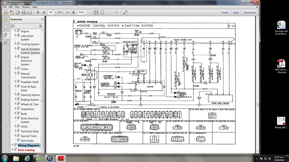

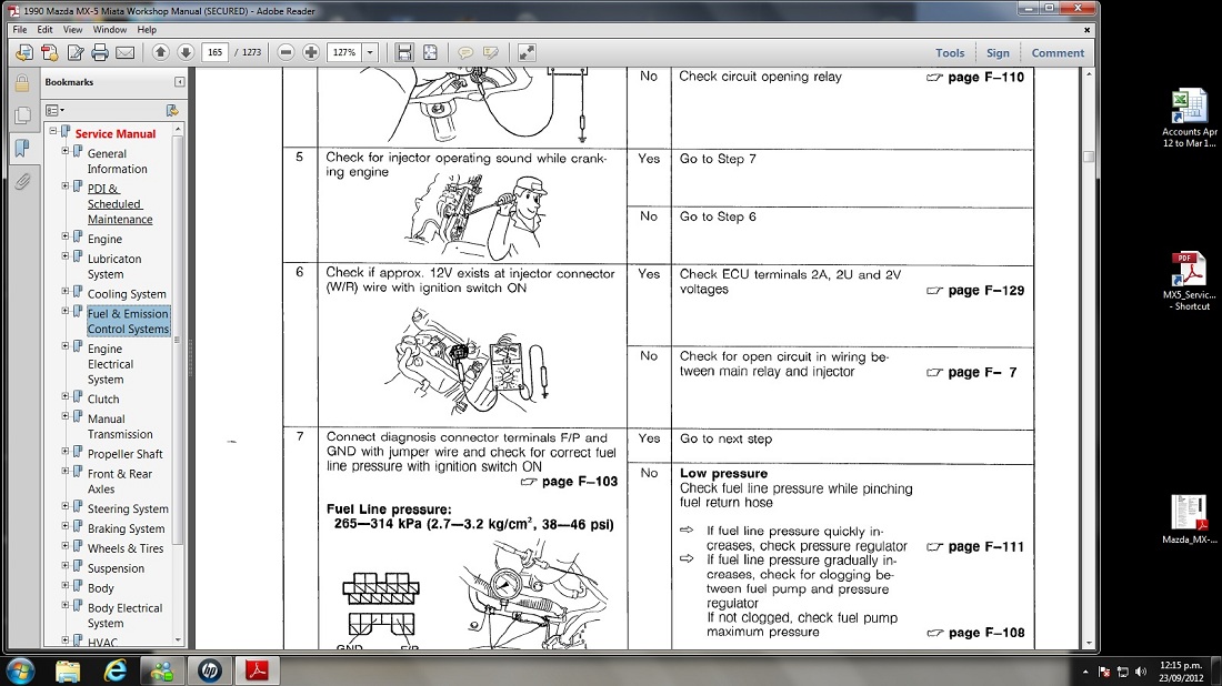

Thanks for the info about making sure that I get a computer from an auto.
The code label on the computer from my MX-5 is:
B66B
EGI
B66B 18 881B
079700-3051

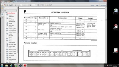

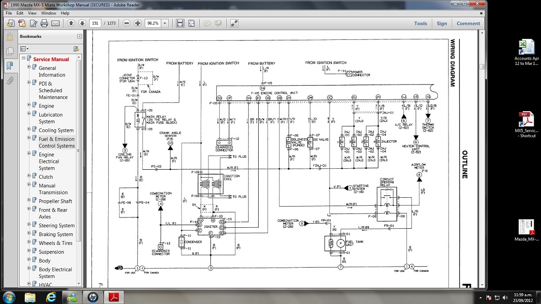

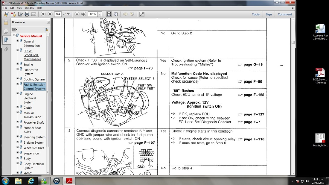

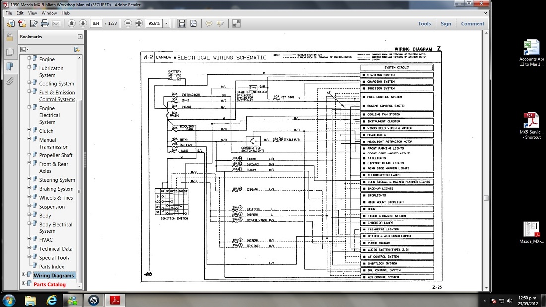

Thanks for the wiring and control diagrams.
We were getting power to the Injectors, but they were not switching. From what I can figure the ECU was not grounding them. We had 12 Volts on both pins of the injector with the key ON.
We checked all the ground connections, and the looked good, we took them off and cleaned them and put back on again and all OK. The two we checked were in the engine bay on in front of the passenger side.
I figure we had power to the ECU as the engine was cranking and we had good spark - is that a fair assumption?
I saw some instructions on Miata.net about getting the check engine light to flash a fault code, and tried that, but it did not work. (It is meant to flash one set of flashes, then a gap, then a second set, to give a 2 digit number.)
A multi meter will not really register the voltage correctly especially with the negative switching of an injector. You SHOULD have 12 volts on both injector pins when the ignition is on but not cranking.
Also you need to use a good quality LED light to check the injector channel as a normal test lamp cannot respond fast enough.(we are talking about 4 milli seconds here)

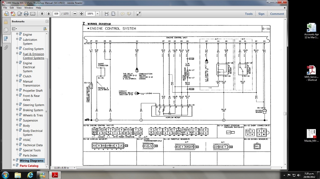

I am pretty sure the ecu has seperate earths for the injectors.(it has multiple ecu earths).
The ecu earth plug is under the windscreen wiper motor and washer bottle on the chassis rail.. it is a large flat white plug with about 6-8 wires in it, and i have heard of them failing requiring the wires to be cut off the plug and re-crimped into a lug....
so before replacing the ecu i would unplug the main ecu plug and check that ALL the earths have continuity between the chassis and the plug pin. and also that the two injector switching wires have continuity from the injector to the ecu plug.
if thats all good and you still have no fault codes then replace the ecu.

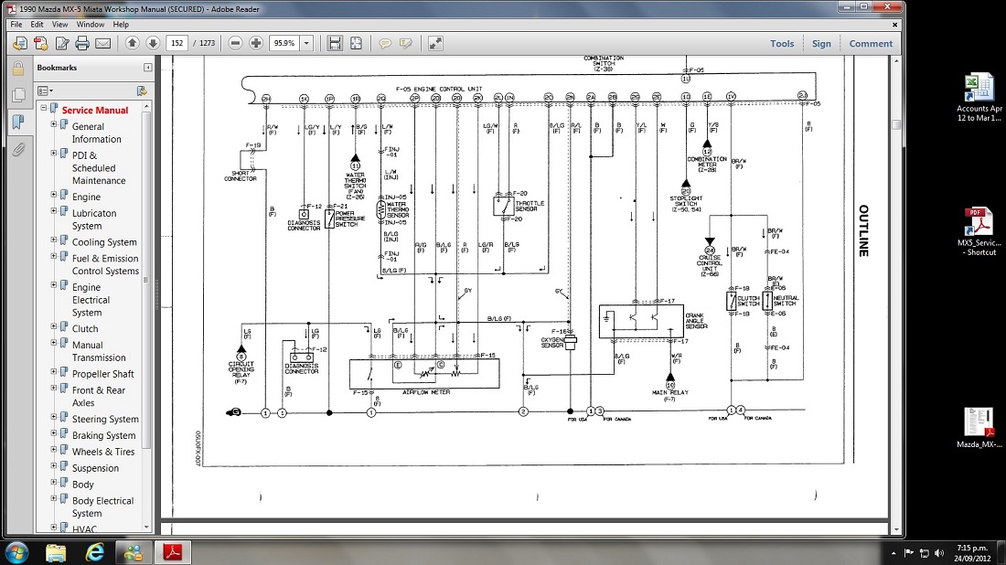

With regard to the injectors the power stayed +12V on both pins even when cranking. We put a "noid" light in place of the injector, and it did not flash when cranking.
I will check the earths that you suggested, and verify that they are all OK. I will need to get some longer wire to check injector to ECU continuity, but will do that and see how that goes.

how did you get on checking ALL the earths? remember theres more than 1 ecu earth.
For starters, theres 2A,2B,2C,2D to check on the ecu plug to ground
