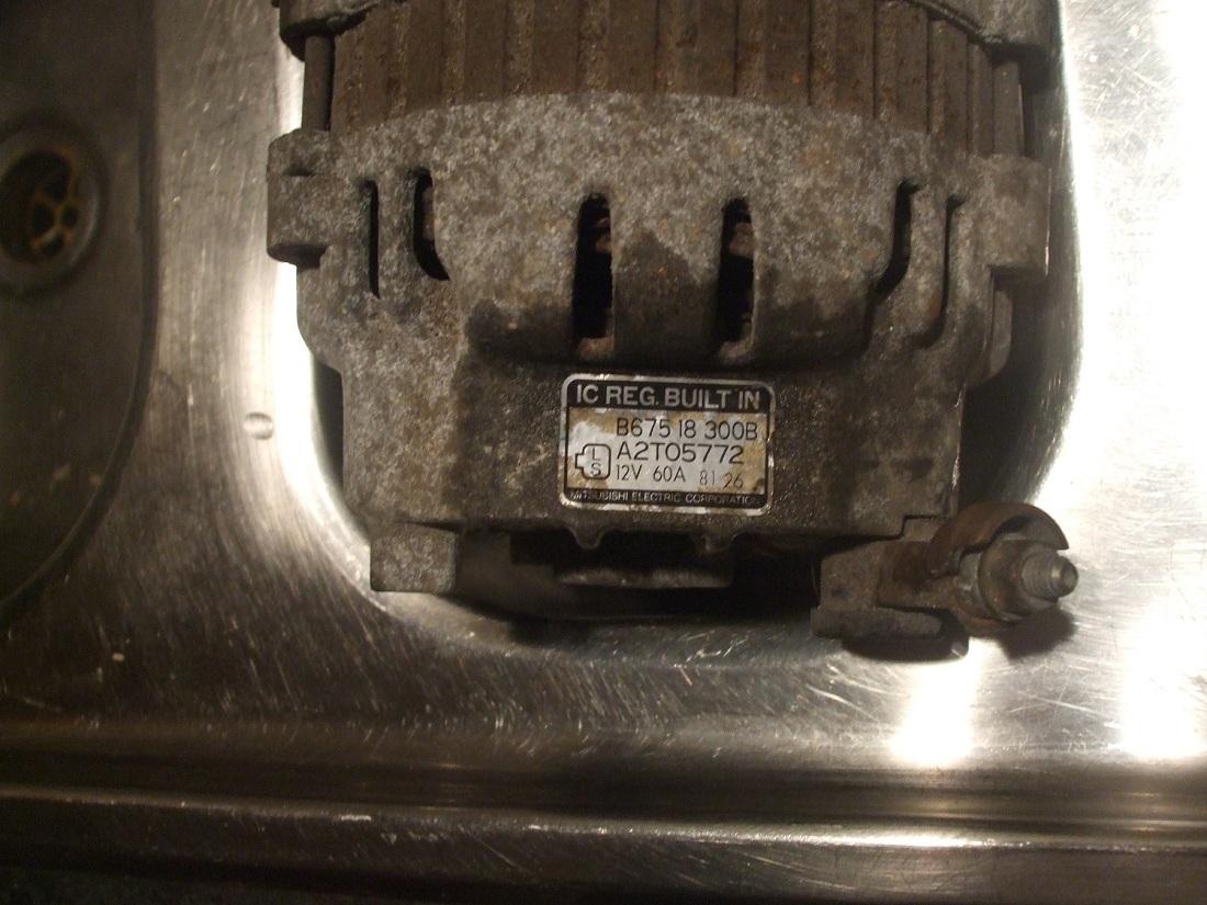

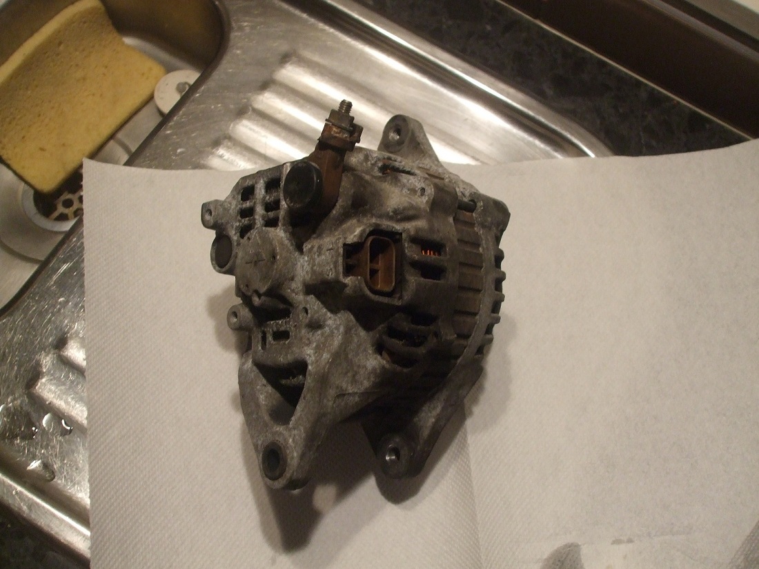

have you got the part number on the sticker?
Alternator
Post by WideOpenThrottle » Wed Aug 29, 2012 8:53 pm
Hope you can read it!

na6*dori
Posts: 115
Post by na6*dori » Wed Aug 29, 2012 9:02 pm
that will work, part number x references to the mx5 and a 323 and the casing etc is identical
