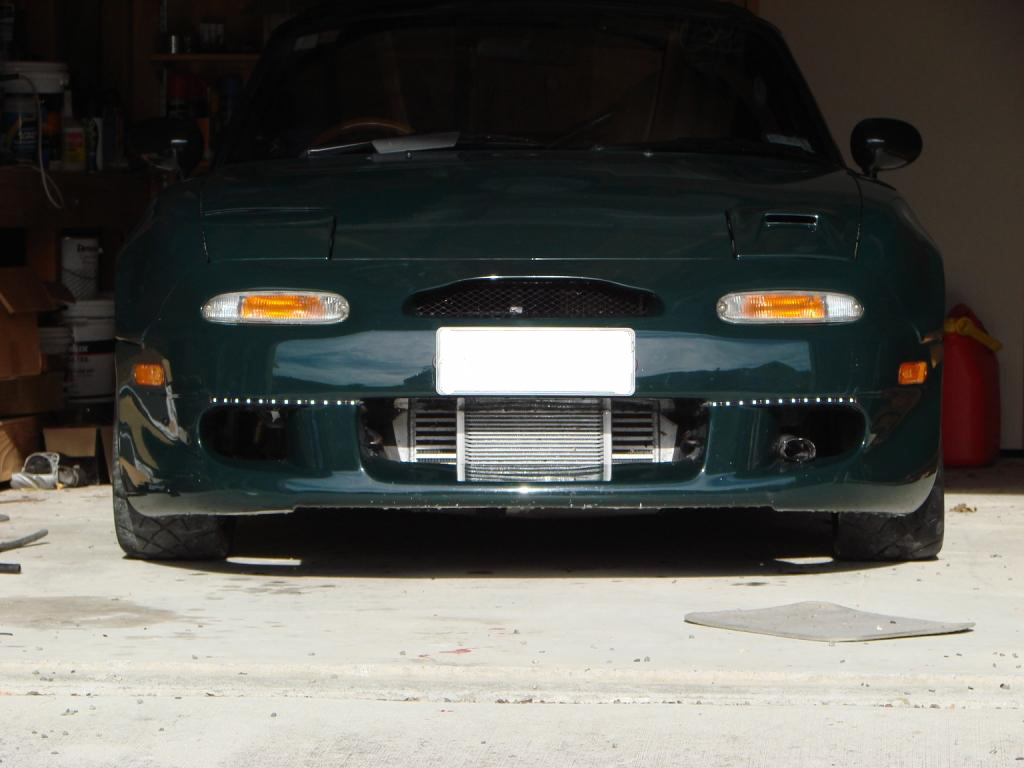

I have SMD led strips - they are excellent and can be seen from a great distance. To make it simple I just connected them to my park light wiring.
- photo

Nice placement for your DRL's, thought I would put mine by the number plate (looks alright, numberplate needs straightening up)!
I posted my pics in another topic, with a small instruction set on how I set them up. Put them on the blue wire by the Passengers side Light, not sure what this is meant for but works for me (works only when ignition is on). Also stays on with the main lights on.
