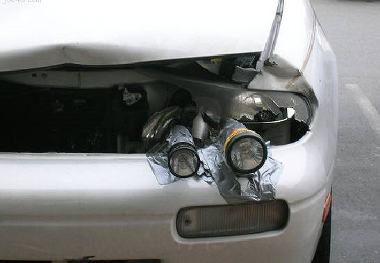

I guess you could always try something like this.
