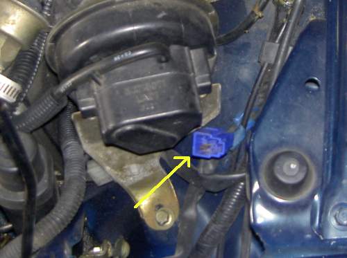

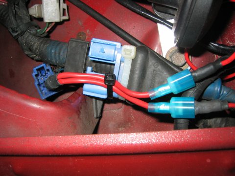

Attached is a pic stolen from this site:
http://www.rivercityroad.com/garage/timing.html
and one grabbed from here:
http://mymiata.paladinmicro.com/Miata4-WireO2.htm
This should show you which is powered - although this only shows a single pin connector as sprsta mentioned.
There is also mention of it here:
http://www.miata.net/garage/ignition.html
Can you possibly test with a multimeter/test light etc?
