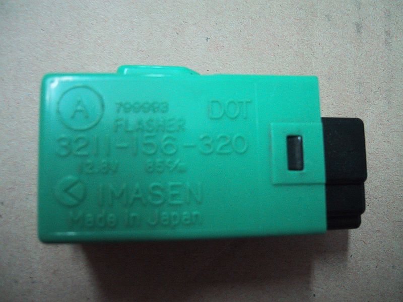

Post by mazline » Mon Jul 07, 2008 5:23 pm
Find this box !!

Post by zorruno » Tue Jul 08, 2008 12:06 pm
on 7/07/2008 5:23 p.m. mazline wrote:
Find this box !!
How can we keep suggesting ways to fix it if you insist on giving the
correct answer straight away? ;)

Hi Mazline
Thanks for the photo and info... I take it this is under the steering column?
Posts: 202
Post by mazline » Tue Jul 08, 2008 5:33 pm
yep,It's a grey box not green one mounted to the right of the steering column about the size of a ciggarette packet.
So long as the numbers match it does't matter what model mazda it comes out of,We get $35+gst for them as a idea,if you get stuck we do have one ,$43 all up including delivery by courier overnight.
