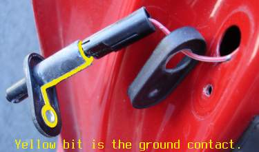

NA interior lights
On Mon, May 07, 2007 at 08:05:09PM -0500, zorruno wrote:
On my trusty mx5, the door switches are very basic. The main shaft has
a contact on the back (part of where the cable attaches) and this
touches a ground ring (artistically coloured yellow in my picture) when
pressure is released from the pin. The ground contact gets its ground
via the mounting screw.
The switch can be disconnected from the loom just by pulling the contact
off the back. (you probably want to be holding the switch pin in while
you do this, so things don't go flying around)

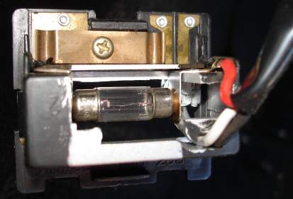

The switch in the light assembly is more fancy - it has a sliding
contact and everything! In the photo, the sliding contact is the brass
bit with a Phillips screw in the middle of it. If you want to clean the
contacts, undo that screw and polish up the metalwork with some brasso -
make it all nice and shiny and clean. Don't use a cleaner that leaves
any sort of protective clearcoat!
Before reassembling the switch, you might want to bend the sliding
contact a little if it needs it, to increase pressure.
The whole light assembly is removable - if you pull out the cable enough
(about 10cm) you'll find a connector, probably wrapped in foam to stop
it rattling.
Karl.
That's a giggle, Z-boy! 'Switch' is almost too grand a term.It has been a while since I looked at one of those switches, but aren't
they semi-sealed? i.e. aren't the contacts enclosed inside?
it rattling.
Karl.
