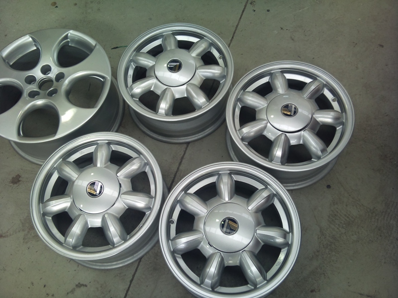

Here are some wheels I had dipped, sanded and repainted. I think they came out alright!

Post by biff » Thu Nov 03, 2011 3:21 pm
They look great!
Brand new even :)
