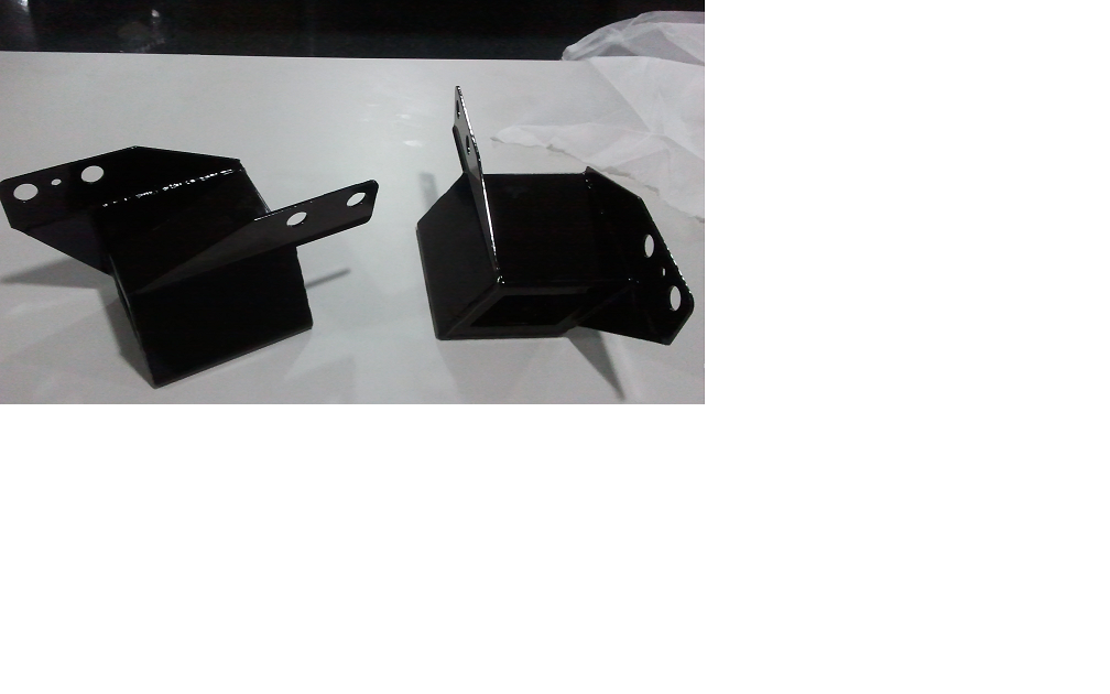

So im running Whiteline sway bars on my MX & over the weekend i realised ive destroyed my front sway bar mounts
Anyone running anything in the way of a Heavy duty sway bar mount ???
If so, who did you get them from ????
Or dose anyone just have some suggestions for replacments ????

I've got the Racing Beat support blocks. If there's a large enough interest I can probably get measurements and get some made up locally. (Though I assume you will need new mount points regardless)

I just welded in 50x50 3mm shs to support the swaybar. They are not going anywhere in a hurry.

I'm also running the Racing Beat support blocks.

theres a wicked video i watched which was an under car shot at the mount while going around a racetrack....
definitly thought about the mount braces after that. the braces basically stop the mount from compreessing up towards the chassis and breaking.

& the solution
